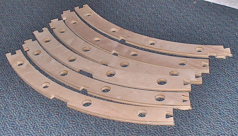

Postby GPW » Sat Jun 08, 2013 2:21 pm
A successful trip to Vinnie’s .... got the nose ribs cut out on the machine .... moving right along ... :D

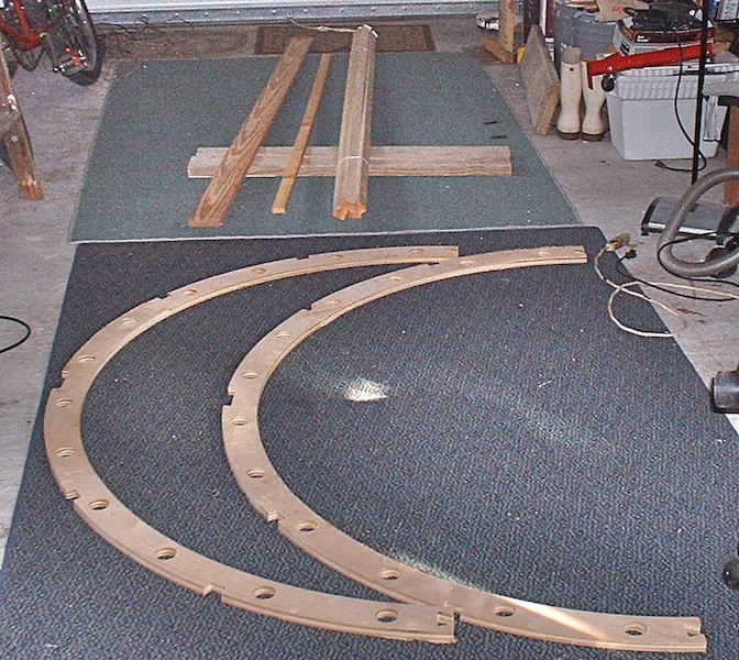

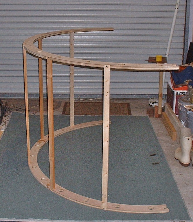

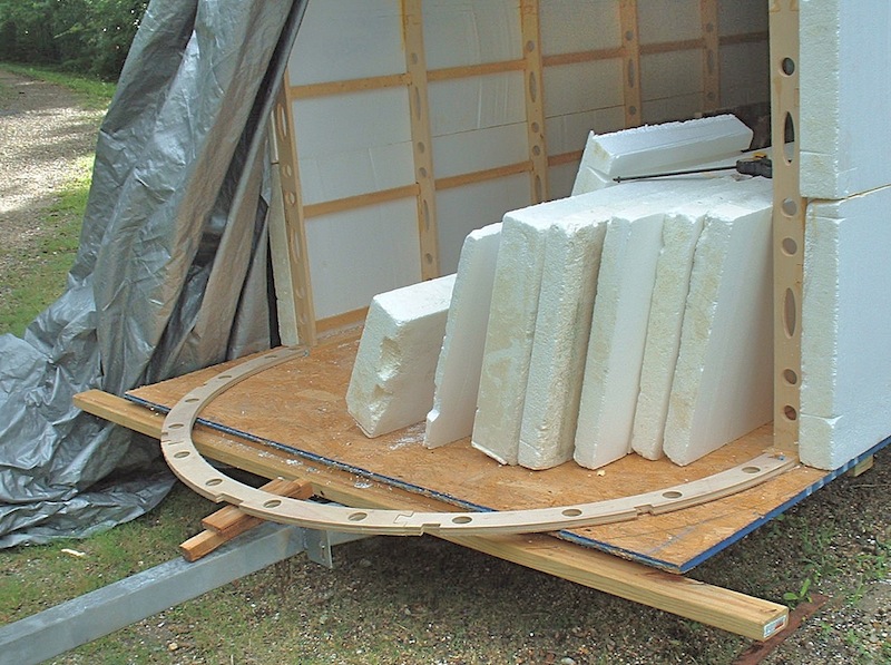

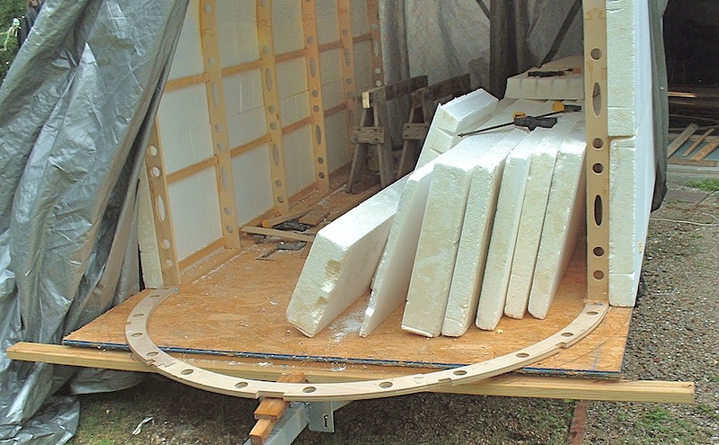

Postby GPW » Sun Jun 09, 2013 8:41 am
More pics ... the ribs and lumber (more than enough ) ... and how it fits on the trailer and how much I’ll have to block up the front end.to get it level .. :o and another view of that ...
The top rib will be parallel with the bottom rib and at 40” high , or just to the shoulder on the puzzle connection where the cabin rib goes from straight to curved.... connected by stringers just as the side was done ... ;) A half cylinder , 40” tall ... the quarter sphere of foam will sit on top of that ... :D

Postby GPW » Sun Jun 09, 2013 3:03 pm
I hope not !!! :o
Here’s the nose cage ...
