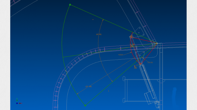

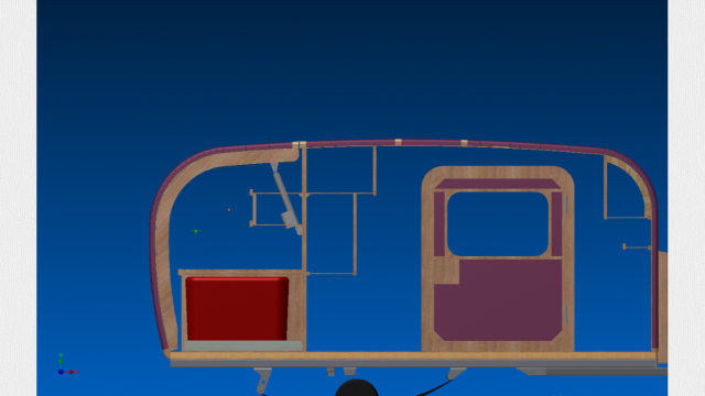

I spent some more time on the hatch actuator arrangement this evening. Once I reduced the swing of the hatch to 65 deg I was able to locate the ideal anchor point of the lower pivot bracket at the cylinder end. It ended up being a little below the lower galley shelf and a little behind the bulkhead very near one of the bulkhead xmbrs.
So from there I fudged the location forward and up a little so that I could tie into the xmbr using the lower bracket design shown below. I plan to add an additional block under the xmbr (not shown).
Here is an overall shot with the hatch closed.
And here is one with it open.
And here’s a close up of the geometry.
{I hope these images are clear enough to see. I accidently exported them from Inventor as bmp’s and had to convert them to png. If they are fuzzy, I can try again another time.}
The bulls eye’s at the end of the green lines, connected by the green arc (32.7 inch radius), represent the center of gravity of the hatch in the closed and open positions. The hatch is raised 65 degrees from closed to open. The green line in the middle represents the midpoint of the hatch travel.
The red arc (9.3 inch radius) represents the path that the rod end pivot point travels through. The red radii originate at the hinge and indicate the starting and stopping points for the rod end.
The 11.1 deg difference between the red and green is the compromise between the ideal 90 deg dwell at mid stroke that was made to put the lower anchor point on the xmbr.
I may try another version where the lower bracket is raised enough to get the cylinder above the shelf panel, but, due to the retracted length of the actuator, the higher up the actuator is the further to the rear the rod end must be, and the worse the angle of force gets. The actuator has the most strength when acting at 90 deg thru the dwell point. The longer upper brackets and the lower position of the lower bracket help this angle stay close to 90.
The model has the hatch weight at 48 lbs before any allowance for canvas, paint, taillight mounting and taillights, galley light, wiring, paper towel rack, screws, latches, the actuator brackets, etc. What I am trying to say is the hatch will get heavier. The ratio between the CG and the rod end bracket-to-hinge center radius is 32.7 / 9.3 = 3.5. So without even considering the force vectors (loss of power from being away from 90 deg), friction, direction of gravity, etc. the pair of actuators must lift over 48 x 3.5 = 168 lbs.
Looks like it will definitely take two actuators, and before everything is said and done, that may not be enough. Sure would have been nice to have the longer 12 inch travel actuators.
I did attempt to do an FEA to see what the software would say the load was on the actuators (accounting for gravity and angularity), but my desktop at work didn’t have enough nut to get the job done w/o grinding to a halt; which is where I ran out of time. I’ll try again using a mock up with just the hatch and related actuator parts, and close the big camper model before running the FEA next time.

Is that 48 lbs the total weight of the hatch or did you add in the leverage from that specific point? Leverage is your enemy!
Randy
RandyG
Posts: 695
Images: 115
Re: The Poet Creek Express - Foamie Hybrid
Postby KCStudly » Mon Jan 14, 2013 11:30 pm
The 48 lbs is what the whole hatch weighs in the model as it sits (i.e. nude and not rigged out, to use a nautical term).
The ratio calculation and 168 lbs is a rough theoretical estimate of what both actuators would see if the hatch did only weigh 48 lbs. So 84 lbs each for two actuators. the problem is that for every pound that gets added to the hatch from here on, each actuator will see about 1.75 lbs added.
Reduce the rating by a couple of percent (cos 11.1) for the angularity, and that means that another 9 lbs of hatch weight and I have exceeded the rating of the actuator. And that's not the worst case; I should really de-rate more for the start angle.
I suppose I could be off somewhere, but if so, I don't see it at the moment. I mean, it kind of makes sense when you think about how many people have had to go and change their struts to stronger ones; it's very easy to underestimate all of the factors that go into figuring the true load on the struts.
Well, I do have four (4) of the actuators. How do you all feel about me adding a rib and using three of them? I might have a little bit of shelf space left over for spices and Bisquick.

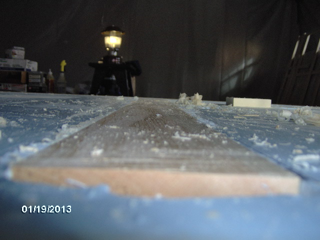

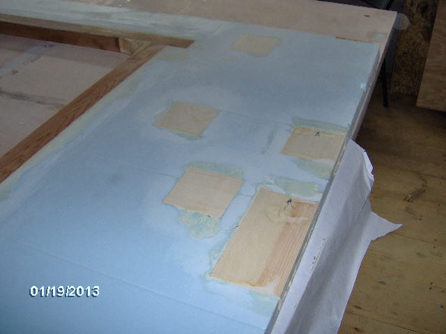

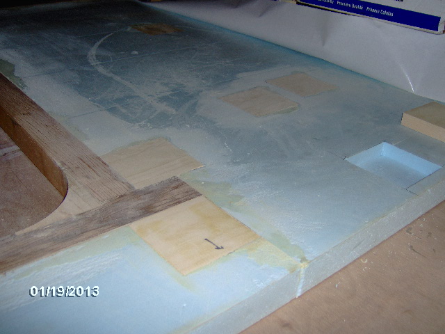

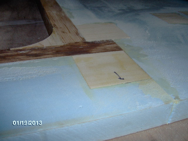

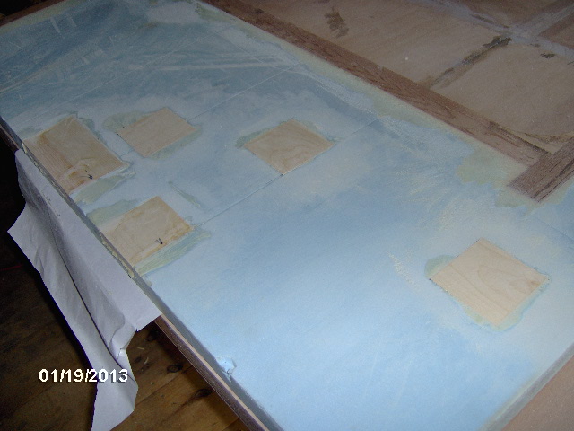

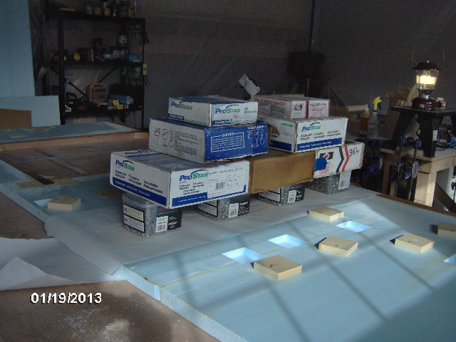

Now about the build: I made it out to the shop today. GG’d the long bulkhead blocking into the recess that I previously routed into the interior side of the street side wall. Shown here under plastic lined freezer paper, four (4) tubs of stainless steel screws (one of Karl’s business collaborators over bought on a project), and a pile of boxes of spooled MIG welding wire.
While that was kicking off I switched my attention to the forward and mid cabin blocks that I had glued in previously. After trimming the raised up glue with an old serrated steak knife I decided that the palm sander was the best way to knock these back down fair. The GG had pushed some of the blocks up here and there and the palm sander pad was about the same size as the blocks, so there was less tendency to accidentally remove foam from the surrounding areas (which was easy to do without trying).
Here are the mid cabin blocks after fairing, looking from the top of the wall down.

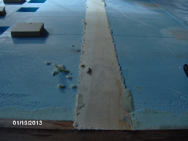

Sneaked a peek under the freezer paper at the bulkhead block and was not pleased to see that it had pushed up a little more than 1/8 at the top rear (right side in pic), less at the top front (left side in pic).
It wasn’t as bad at the bottom; just 1/16 at the rear and more or less flush at the front. Seriously thinking about switching to PL or thickened epoxy at this point.

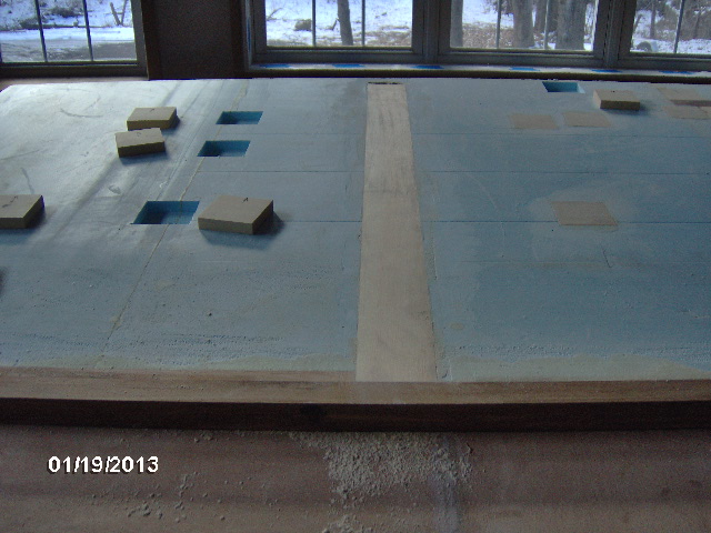

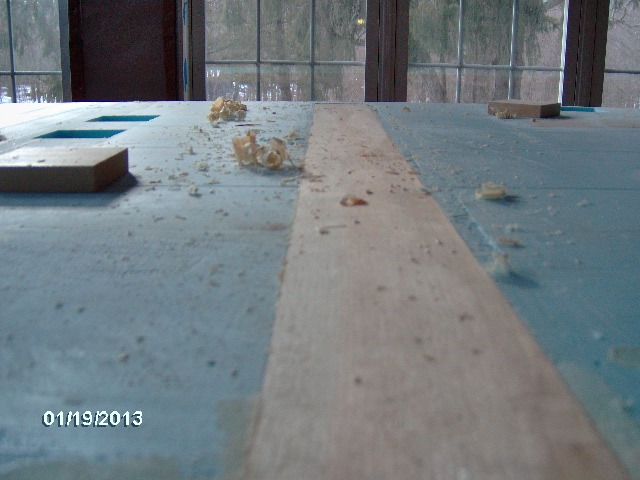

Here it is right side up looking from the bottom sill up toward the roof. I have started to trim the excess glue with the knife, though the small Sureform plane would have worked good, too.
I used a combination of the powered hand plane (tended to gouge a bit), the hand bench plane (very controllable), the 10 inch homemade sanding block with course belt sander belt, and the hand held powered belt sander to knock it all down.
It’s getting there, still a slight crown in the middle.
And here it is in pretty good shape after some more sanding and a little clean up.

Too bad about the GG lifting the wood. Looks like it makes for a lot more work and hassle. I have worked with GG a bit and find that it is a bit of a art to work with. I have done no big projects so I really do not know what to expect. With my small projects I have found that using different amounts, with and without water, gives quite different results. I do know that with a lot of moisture that it foams up quite a bit and you only want to use a small amount of GG.

George (ghcoe), Yeah, I suspect that I am using too much water. I have spread the GG with plastic credit cards fairly thin. Usually I run a few strands of glue, spread sparsely, and then I add a bit more here and there to achieve an even coat with no dry spots (I suppose I might be letting some excess build up in the corners… maybe I should cut the radius corners off of the spreaders). My spritzing water bottle does tend to spray a coarse splatter, rather than a fine mist, so I have been spraying the wood side and wiping down with my rubber gloved hand, just damping the wood evenly. With the cold temps the GG seems to take a while to react, and the temptation to spritz the glue side becomes overwhelming at times, so my problems are probably self-induced. I will have a talk with the operator (me) and see if I can get him to use less water.
