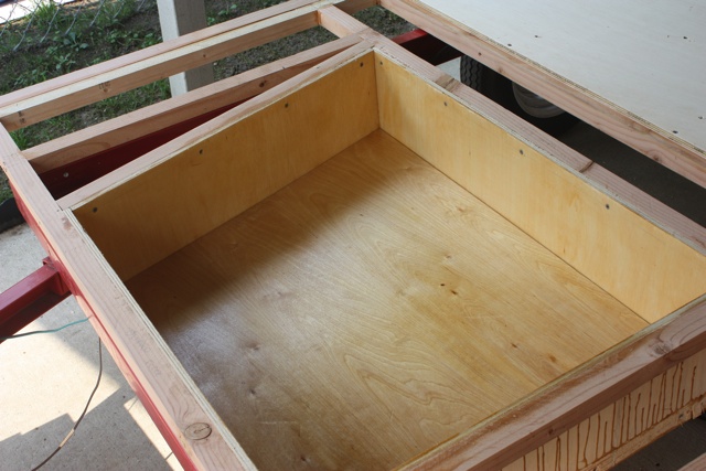

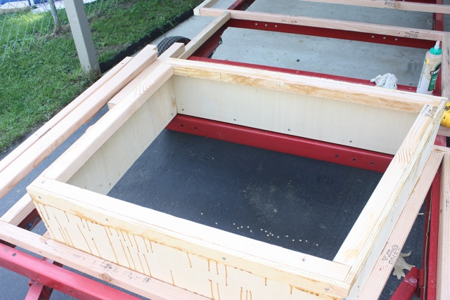

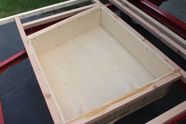

These 5 pics will give you an idea what I am playing with today...

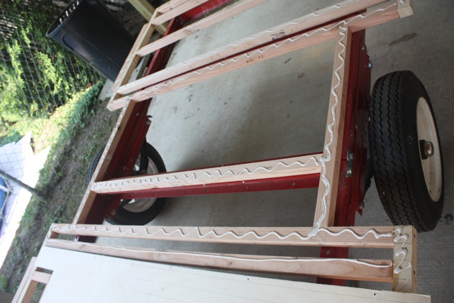

Here I've glued on the subfloor cleats on the inside of the dropped floor. I tried doing it on the outside a couple weekends ago, but then I couldn't get the dropped floor to drop into the hole in the frame. :duh:

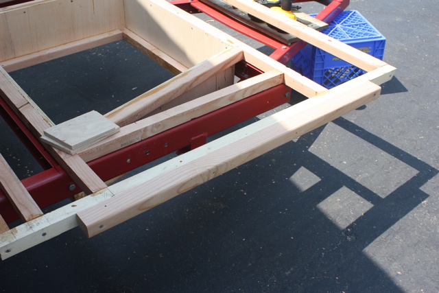

Here's the dropped floor installed. We are going to put some poly on the dropped floor this afternoon, so we don't mess it all up with dirty footprints!

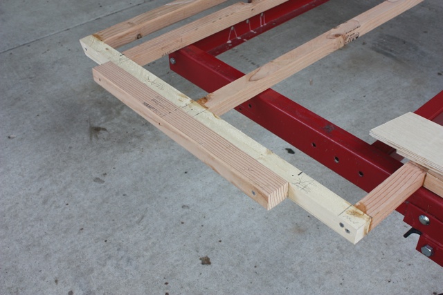

I also installed the keys on one side. The position seems right, so I'll take em off this afternoon, put some glue on them, and put them right back on. Here's the front key... (BTW, notice how it reinforces the front overhang!!! :thumbsup:
Here's the rear key..

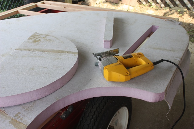

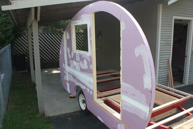

P.S. Has anyone ever tried cutting foam after the canvas has been glued onto the sides?
Postby eaglesdare » Sat Jun 04, 2011 12:19 pm
oh mike that is looking great!
i did cut a hole in the foam for an outlet, before the canvas was on. once the canvas was on i forgot about that hole and have never gone back to cut thru.
so if you do it, you will be the first. that is unless gpw or pat has, but i don't remember them saying anything about that.

Great Pics ... 8) 8) 8) Love those Keys and dropped floor !!!!! :thumbsup:
Best score through the canvas before you cut the foam (utility knife and a metal ruler ... careful not to slip and cut yourself)... to locate the corners inside , just drill small holes in the corners... connect the dots . Score inside fabric too and the cut will be super clean ... Tried it on samples/scraps

I want you guys to know that cutting foam with canvas is wonderful, easy, and clean! The canvas became part of the foam, and didn't need any special treatment. I cut it with a jig saw, piece of cake!!!

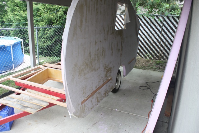

Here I've set the wall in position...

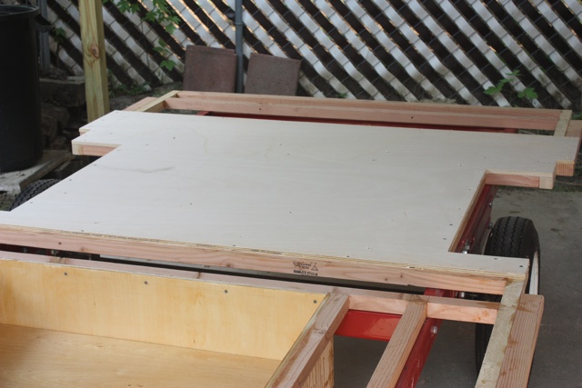

Okay, the plywood is down, and the screws are in... Notice how the plywood covers the keys!!!
I mentioned earlier that we were going to get some poly on the dropped floor. Here's what that looks like...
