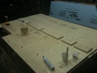

Profile's cut!
And the first wall being glued/clamped/weighted:
240 lbs of tire/rim and 180 lbs of I-beam should make for a straight/flat layup! :worship:

Postby GPW » Sun Sep 11, 2011 8:27 am
DJ, how are you making your â€
Postby DJT » Sun Sep 11, 2011 3:18 pm
Gpw,
The sides (from inside -> out) are:
(1st lamination)
- 1/8 "Virola" ply
- TBII
- 2" Foam (2nd lamination)
- Exterior enamel paint
- 10oz canvas (doubled up along seams and edges)
- finish paint
(possible 2nd lamination of 10oz canvas if necessary)
All the walls will have the typical hard points and framing around the openings. There may be additional framing installed to support the bunk, but we'll add that as needed.
We are not planning to use spars for the roof, but at 66" we may need them, and they will be necessary around the moonroof and the vent.
We haven't figured out the wall to floor mounting yet, but I'm thinking of insetting a 2x2 then wrapping the canvas around and under by 8".

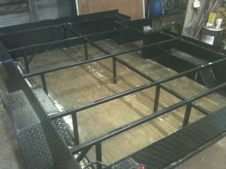

Postby DJT » Thu Nov 17, 2011 12:53 am
Well finally got some time to get back to the shop! Not much progress yet (at least on the trailer, 3 cords of wood is in, and we're mostly ready for the winter!), but I did manage to get the last of the wall panels laminated (reminds me I still need one more piece of luan...), the "basement" floor in,
and the cabin floor trimmed and joined up.
Next will be a lot of pieces getting stuck together (hopefully where they need to be!) and should go along a fair bit faster.

Postby DJT » Thu Nov 17, 2011 8:24 pm
Sorry, pictures added!
DJT
Posts: 102
Joined: Wed May 11, 2011 6:46 pm
Location: SW Ontario
Postby atahoekid » Fri Nov 18, 2011 12:16 am
That frame looks pretty stout. :thumbsup: :thumbsup: I imagine it would take a pretty good thumping to break it apart. So far, it's looking real good :thumbsup: :D
