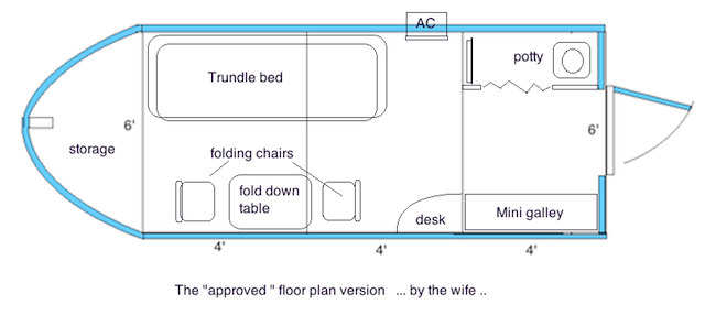

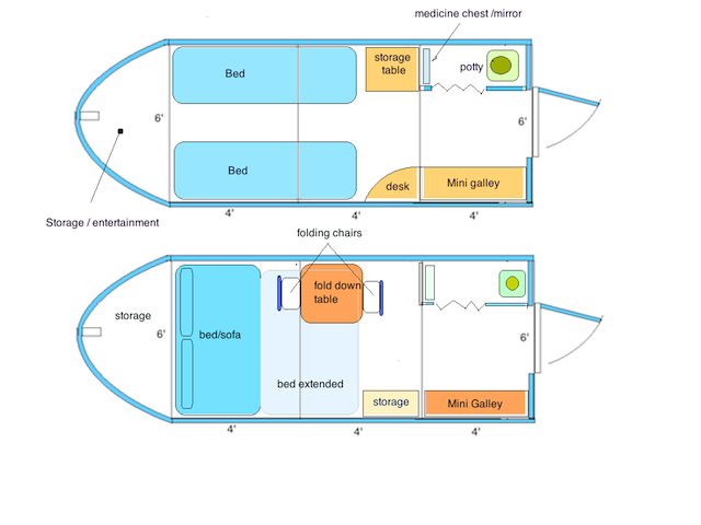

Postby GPW » Thu Jun 23, 2011 5:06 pm
I just had to go and ask the wife's opinion , she didn't like either of the previous versions, so I did this , which she does likes ... :roll:

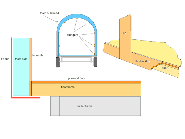

Postby GPW » Thu Jun 23, 2011 5:57 pm
Here's a drawing of the proposed rib attachment method, with filler strips between the ribs to level the surface for foam attachment ...
Went to the guitar shop today (while the site was down) My Pal Vinney said it would be no problem bending the ribs that size .... he suggested Pecan over Hickory because it was locally available , it had similar bending properties , and he would cut the strips for me on his Big saw ... 8) :thumbsup:
Postby starleen2 » Thu Jun 23, 2011 7:04 pm
GPW wrote:
By the scale of your drawing - it looks like a a possible 15 footer camper :thinking:
