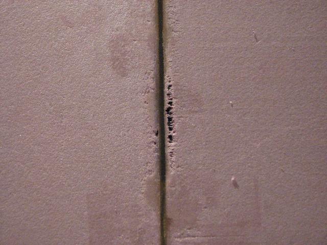

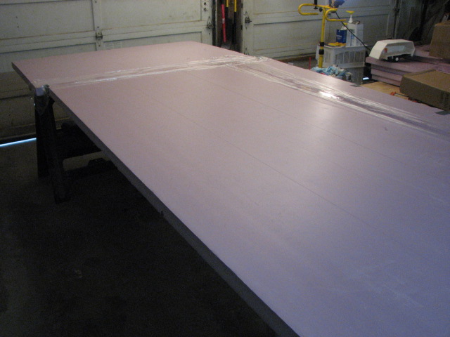

Postby atahoekid » Tue Sep 13, 2011 11:28 pm
So I got my panel glued up. Here's the picture. Sorry it's taken at a crappy angle but that's all the room I've got in the garage. It's just over 11 feet long and just over 5 feet tall. I'll cut the profile tomorrow probably.
I figured out a couple things about glue ups and using epoxy while messing with this
1) The factory edges aren't perfect and they don't touch in all places when they are butted edge to edge so you need to get creative when you join them. I used duct tape on the bottom side of the panels, brushed in epoxy to get the panels tacked together and let it dry. I then went back with epoxy in a syringe (no needle) and filled in the gaps. I covered the seams with cling wrap to smooth out any overflow of epoxy (that's the shiny stuff running along the seams)

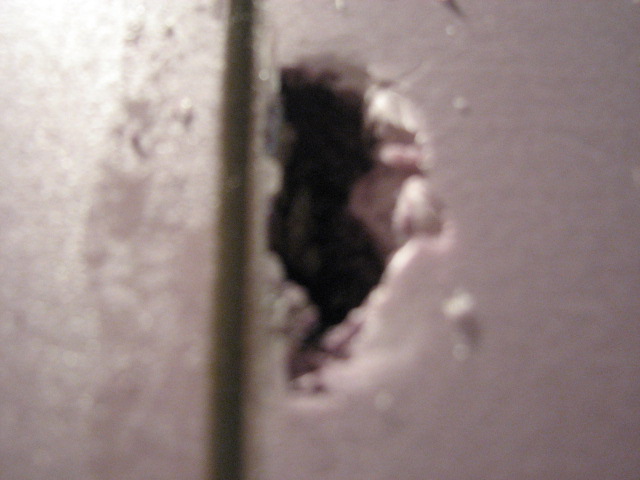

2) Epoxy creates enough heat when curing that a larger "puddle" left to cure will burn a hole in the foam. I found out twice. The first burn hole is about an 1/8 inch long and about 2" long.
That's bad enough. Now the other one
OMG!!! :x :cry: :x :cry: :fb
It's about 3/4" wide by 2" long. Well I guess that I should have filled the epoxy in with multiple passes, letting it dry between passes. it's repairable. I'll cut out a chunk of foam and glue a new piece in . Try that with lumber. One of the joys of working with foam :thumbsup: :thumbsup:

Postby Wobbly Wheels » Wed Sep 14, 2011 12:31 am
No sweat Mel, there's an easy solution for that.
Epoxy on its own tends to be pretty brittle, especially if it's used on a nonporous material like foam. The trick is to use a filler to thicken the epoxy so it fills in the surface imperfections. Mixed to the consistency of peanut butter, it will fill gaps to 1/4" or so with no worries and will spread out the exotherm enough that it won't burn the foam. To fill wider gaps you'll want to use a structural filler like cab-o-sil or wood flour...otherwise microballoons will give you a lightweight (& easily sanded) bond. All will weaken the bond but will still be stronger than the foam and that's all that really matters.
Some other stuff I've used in the past with varying degrees of success-
Talcum/foot/baby powder - takes a lot to do the job, but when it's all that's handy...
Carpenter's chalk - mainly as a solid pigment for inlay
Dust from a RO sander - not the smoothest but it'll take a screw really well
graphite powder - sold as a dry lube, again it takes a lot but it leaves a really hard surface.
Fillers will also cut down the amount of epoxy you use by increasing it's volume quite a bit....see, even epoxy can be thrifty !

Postby atahoekid » Wed Sep 14, 2011 12:05 pm
Brian,
Thanks for that info. I'm sure it will come in handy as this is just one side. I've got the other wall, the top and the back to glue up yet.
I've said it before, I try to learn at least one new thing every day. Yesterday I learned the hard way, today it's the easy way. :lol: :lol:
