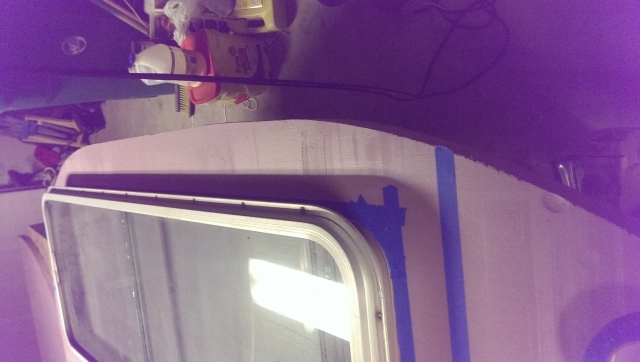

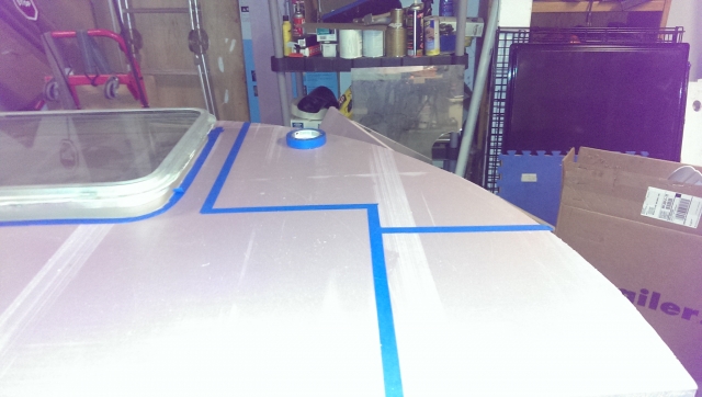

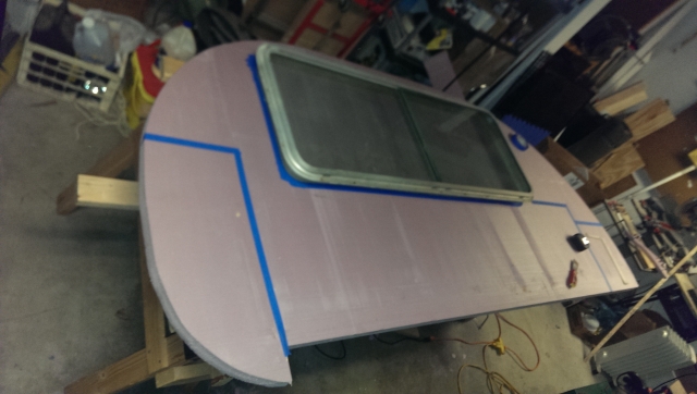

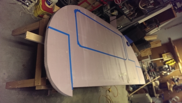

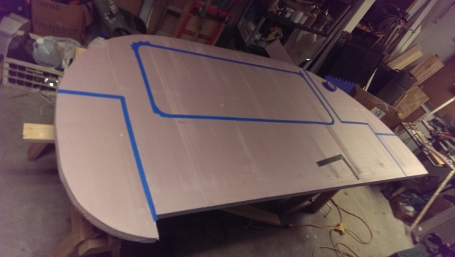

The tape that is not hear the window indicates proposed internal framing, the headboard/shelf up front, and the galley area in the back.
I then started putting some tape around the inside of the window cutout area.
There isn't a ton of room between the wall separating the galley and the window.
the window is 5" down from the top of the wall. That means at the front curve at one point it is just about 3.5" from the roof.
Inside of the tape lines is where the cuts would have to go to put the window in. Framing would be where the tape is and of course further out. I was thinking 1x3 maybe?
Possibly I could/should run some supports to the floor to help hold up the weight?
Or is this too big all together? I am waffling about cutting the window apart and using the two big panes of safety glass each for a wiley window.
I think the giant window would go a long way towards making the tiny trailer seem HUGE inside.

I think I would opt for the two windows and two doors, one on each side. I love the thought of a huge window but............there are lots of reasons I would not. with a window on each side you get thru air. you can put a fan in one side and blow the air out the other getting lots of air. Wiley windows are easy to make , you will enjoy seeing out when you want. I just went camping and found that it was fine being smaller windows could darken easily and I don't plan to stay inside all that much that I need big window. nice but just not necessary. I was outside during the day and just slept during the nite.

I do have a smaller window 15x22ish for the other side. So I can still get cross ventilation.

Personally I don't care so much about how large my overall window size is, as long as it is all able to be opened. a crank out window is good, but a sliding window is a major light leak when I want it dark to sleep, and being a slider won't open fully. The wiley window allows the whole window to be opened for airflow, the more the better! If you have a vent fan (I don't) make sure your curtains can be used to direct the airflow downward, some people use this instead of an air conditioner. If you have a ceiling fan in your bedroom you know what a difference this makes.

One of my concerns about putting in the windows is getting it too big. I think the wall as a solid piece is pretty strong, but as a seismologist told me when we were discussing structural integrity of the door frame. "You put a hole in a perfectly good wall". I think I might get smaller windows. Just my opinion....

if the window is framed properly, it will be stronger than a plain wall

I am going to think about the window issue a bit longer as I move forward with putting on the roof. I really think that properly framed the giant window should be fine. The biggest thing about it is that it is sort of heavy.
