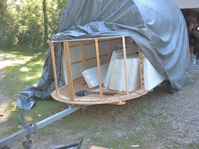

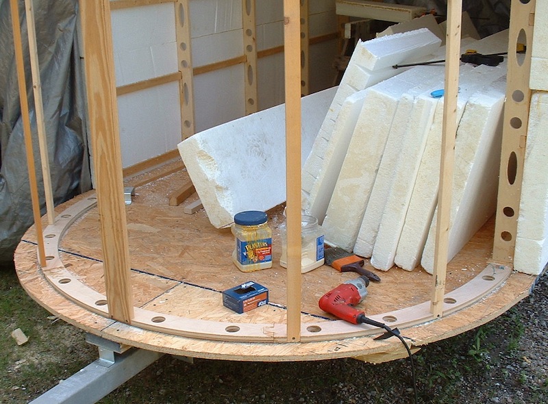

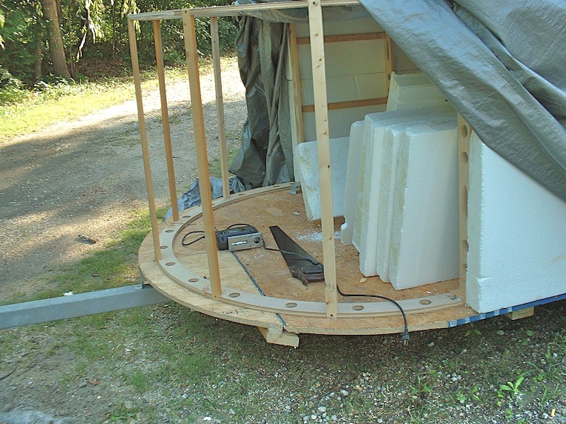

The nose floor support is working out just fine , everything fitting in place , and should be plenty strong enough with several attachment points along the front and inside too ...
OSB, that will be liberally treated with "the mix” (then painted ) on the inside and exposed edges , and of course all the bottom will get an application or two of the black nasty stuff... That should work OK.. The Foamie #1 after all this time is still in great shape ... no problems to report ...so I’m confident of this method ...
Having owned a commercial RV trailer , with an obviously untreated OSB floor on either top or bottom , we know for sure that won’t work ... :frightened:

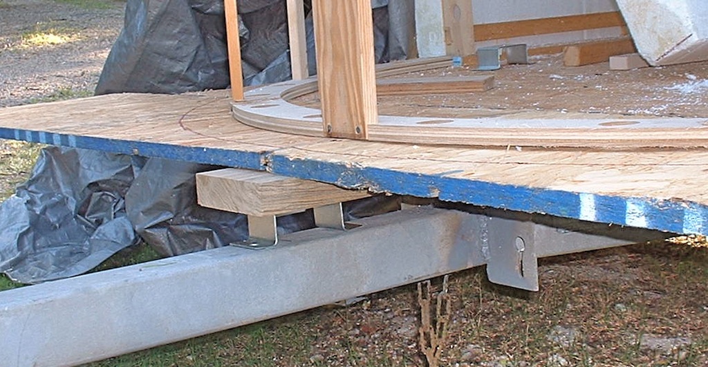

Here’s the floor piece fitted up and marked for cutting to shape ... supported by a block of black Limba , all attached to the HF clip and tongue .. with a secondary support (the 2X4) which will also be trimmed to size and treated ... again ...

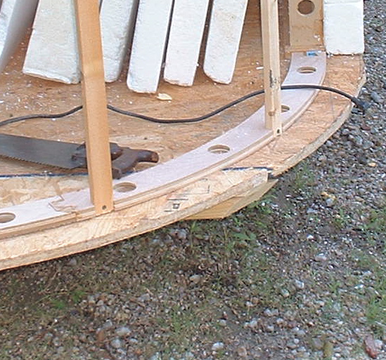

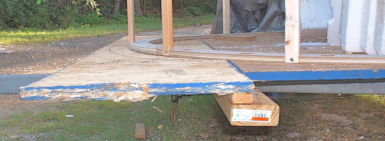

Floor cut in the nose .... the 2X4 that sticks out on the side will be “blended" with the belt sander as to be less obtrusive ... now to glue , screw and bolt it all up ... :D

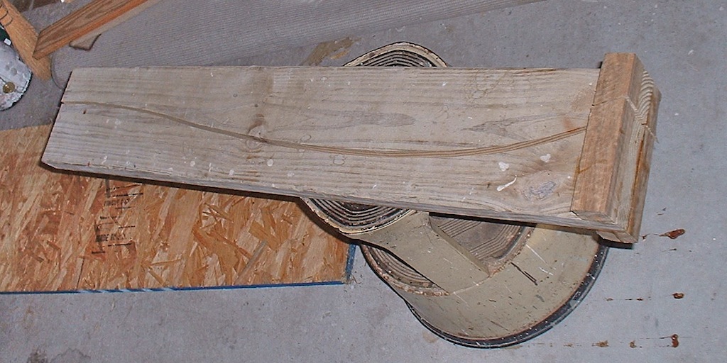

A little pre-trim with the handsaw helps with bulk wood removal ... the belt sander will smooth everything up ... :D

Floor front screwed and glued ... Cage attached to that ...
And it’s now off to the store for more T2 ...
