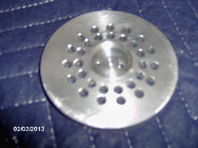

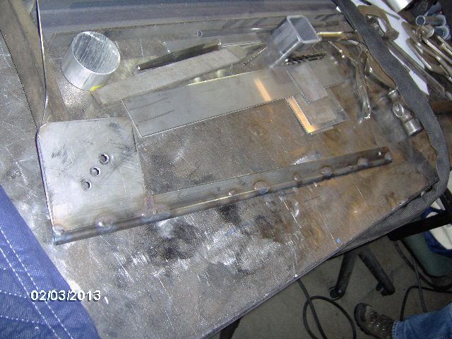

Here is one of the four (4) modioli (Latin for washer) that will make up one end of our two (2) Ethos style (Ethos video) rope bundles on the Mad Hatra scale Model (MHM).
It is 3 inches in diameter.
A std. ballista is like a crossbow or slingshot where the projectile is cradled in a pouch between two sling lines that are anchored on either side by two springs. In the case of the slingshot the sling itself is the spring. In the case of the cross bow the bow arms are the spring. In the case of the ballista the arms are rigid and the rope bundles at the pivot point of the arms are the springs.
A Hatra Ballista has the rope bundles at the outer ends of a stanchion frame (the opposite way around from a std. ballista) and the throwing arms swing from the inside out; going from pointing the tips of the arms at each other to the arms pointing straight forward. This is an ancient design that was very short lived (in a historical sense); a slight improvement over the std. ballista due to the “snap” that you get in the sling line at the end of the throw. Team Captain Eric has done a great deal of study, math, and small to medium scale building of hatra ballistas, as he felt that this snap was a key to better performance.
Well, in history the ballista and hatra ballista were quickly over taken by the onager style of catapult with its rope bundle oriented horizontally, a single throwing arm that travels in an overhand vertical plane and has a sling that “cracks the whip” overhand style like David used to slay Goliath, the guy at the end of a water skiing rope, or the skater at the end of the conga line. Much greater acceleration and a much higher elevation at mechanical release for greater throwing distance.
The advantages of the overhand throw and sling are pretty obvious, spawning the well-known French trebuchet (essentially a gravity powered onager with no rope bundle or spring) many hundreds of years later.
The Mad Hatra concept borrows the best concepts from all of our torsion competitors while still utilizing two rope bundles for (hopefully) more power potential than any others (we have long believed that Mr. B has been the most powerful torsion machine due to our two rope bundles, but that we have been limited by our low knuckle ball release). The Mad Hatra is a two stage machine with elevated onager style throwing arm and sling (like best in class Chucky3; push thru the second ad and the second vid gives a nice overview of the torsion class, with a shot of Mr. B about 40 sec’s in ), but with two Ethos style bundles that require much less structural weight to support themselves from crushing. There are some other oddities that will allow us to minimize our set up efforts and that are driven by over the road considerations, but we hope that this will not affect throwing performance much at all.
Here is the throwing arm (TA) that I built for the scale model.
Sorry for the pour contrast with the work bench.
It is 20 inches from pivot point to arm tip. The spine is 3/8 OD x .040 wall steel. The rib is .100 thk x 3/4 deep SS, and the hub plate is .135 thk x 4 x 4 inch SS.
I’ll just let that soak in for now.

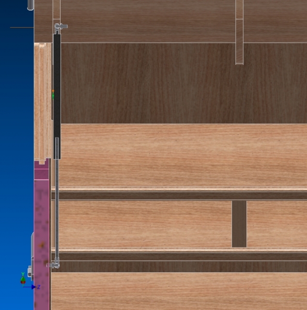

Thanks Bogo for the thorough description and links to those components. I am familiar with shoulder bolts and I used the threaded inserts in my floor assembly to be able to screw it to the trailer frame. I had looked at the clevis, eyelet and ball end (heim) rod joints, too. I am sure that info will be helpful to someone.
There are a couple of reasons that I think the ball stud and socket ends will work best. Here are a couple of the design criteria that I am trying to stick to and my reasoning: (1) I want to keep the hatch ribs as clean and clutter free as possible, avoiding visible holes, but I don’t mind the idea of custom made stainless steel or aluminum brackets and/or tabs. My thought is that the thread inserts would need to go in from the opposite side of the rib and would therefore show (or at least need a decorative plug; not so much a problem in the side wall). That would place the strut on the inside of the rib, further away from the wall, increasing the cantilever forces on the wall mount. The heim joints are longer than the ball sockets and would make the overall strut length a little longer. In order to maintain the recommended geometry while using the strut with the longest stroke available that will fit (and therefore keeping the mounting point on the hatch side as far away from the hinge...and therefore keeping the leverage down) I found that I needed that little bit of room to keep the lower anchor point out from under the hatch rib when it is closed (a side effect of my bustle like profile where the top of the hatch is relatively short and flat while the back turns back in sharply and down, plus the deep ribs). (2) I want to keep the outermost hatch ribs as close to the side walls as possible (about 3/16 clearance), so that the edge of the hatch panel inner skin that compresses the hatch seal stays as rigid as possible where it hangs over the side from the rib. My ribs are a nice deep 3 inches, so I think I will be able to get away with just one 3/4 thk rib per side (i.e. not doubling up the outer ribs). That means that there is very little room between the rib and wall for a double shear style tab (such as would be used with a rod end located under the rib), or even the head of a bolt or nut on a through bolt. I may have to think that through a little better because even if the mounting tab is only on the inside, the fasteners should really go thru, so maybe a recessed plate with flat head screws on the outer face of the rib, and self-locking or acorn nuts on the inside to hold the bracket.
As it turns out, if I use the socket and ball studs at both ends, I can mount the lower rod end to a simple 1/8 thick wall plate screwed directly to the inner wall skin and recessed block (w/o the hardwood spacer I mentioned above), and turn the upper cylinder end stud facing inward. This puts the strut closer to the wall for less cantilever, and aligns the mounting face of the upper ball stud very close to the inner face of the rib (with the strut lined up underneath and very near the centerline of the rib).

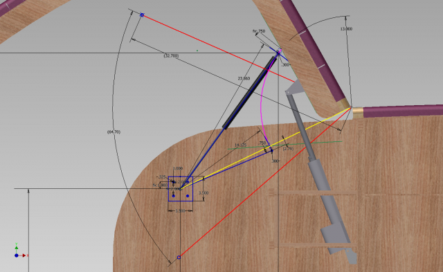

Here is a screen shot looking through the galley with the strut modeled and the curb side wall turned off. The superimposed sketch depicts the geometry.
The red lines represent radii from the hinge centerline to the hatch CG in both the open and closed positions. The magenta arc represents the path of the upper anchor point. The blue lines are the centerlines of the strut in the up and down positions (superimposed on the upper). The yellow line connects the hinge centerline to the lower strut anchor point, showing that the closed strut axis is just over center so that the hatch will not attempt to open itself unintentionally (assuming that the gasket doesn’t push it open).
It has been said that making the strut go over center can pry at the hinge, but I think that may be because no allowance was made for the strut going past fully compressed and then giving back a little. If I was to attempt to do this and just used the collapsed dimension at the final closed point, it would not be able to compress slightly while starting to open (as it goes through the dwell point) and would surely bind the hinge. Said another way, the strut is shortest on the yellow line, just before closing, and extends a little as it sweeps past that on closing.
The linear actuators are also shown. They are my primary plan and I left them visible in this view for comparison. However, I need to figure out where to put the blocking for the gas struts as a backup plan in case the actuators don't work out as planned. I have been thinking that I might just leave the skins off of the galley side walls and bulkhead until the hatch is built and I have proven one or the other of these options. Or just put in bigger blocks for the gas struts to anchor to, giving a little leeway in case I am off somewhere. Better yet, incorporate this feature into the new wall edging pieces so that it is tied in really solid to the wall.
Well, I see that I am rambling and mixing up thoughts again. I hope this all makes sense.

Postby ghcoe » Fri Feb 08, 2013 12:46 pm
I think the gas strut looks like a better solution. Less leverage on all the lifting components.
George.

ghcoe wrote:I think the gas strut looks like a better solution. Less leverage on all the lifting components.
Yup, you’re right, George. The fact that the rod end is further out closer to the CG means that the leverage is reduced, but only as the hatch approaches fully open. Although the CG moves toward the strut as the hatch closes, the angle of the force vector gets closer and closer to the hinge, actually passing it at the last moment. Since the gas pressure on the strut is constant, the leverage at this point may actually be higher than the actuator. The actuator acts on a shorter arm, but stays much closer to perpendicular to this arm throughout its travel.
Suffice to say that I plan on using a suitably robust hinge with a staggered screw hole pattern to really bed the hinge leafs solid to the double spars.
Okay, Bogo has me thinking of some options and I managed to spend a little bit of time on the model before bugging out from work due to the approaching blizzard (my department shut down at noon to allow us to get home before the worst started).
Here is a section cut through the center of both ball studs looking forward and down thru the plane of the strut in the open position. This is the same combination of parts (sockets and ball end studs) that I showed in the side geometry above, except the lower ball stud bolt face has been moved to 1/8 inch away from the side wall skin, allowing for a wall plate which is not shown (no hardwood block required between skin and anchor plate).
You can see how well the strut lines up under the hatch rib. So I decided to look at some other combinations of end types and brackets. The combination of these two parts is looking good for the top with the bracket screwed into the underside of the rib.
