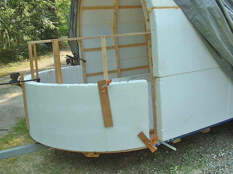

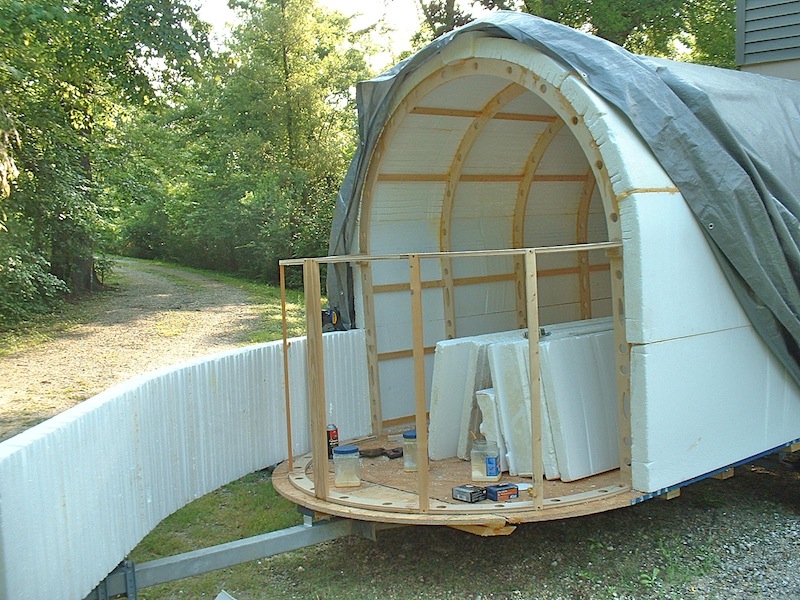

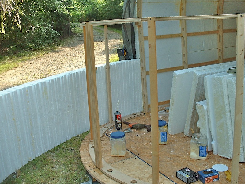

Cool er this morning ... 83F :o ... More kerfing to do , then to attach the panels on the nose ... More mess !!! ... getting closer ... but it might Rain ... :frightened:
Re: FoamStream...
Postby GPW » Sun Jun 16, 2013 8:22 am

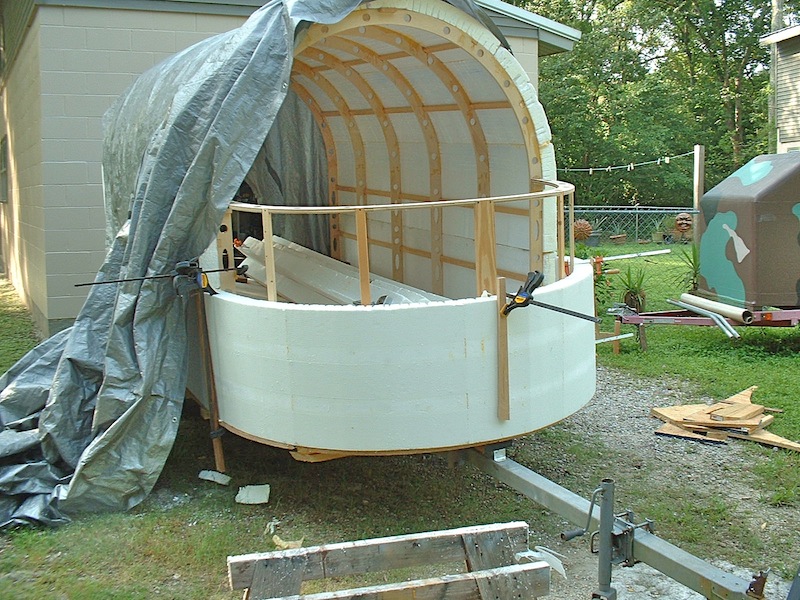

Got all the kerfing done , the foam panels are like rubber now ... :o Started attaching the first panel .... used Great Stuff , because it will dry quick ... Once that’s dry I can bend the panel around the front , and glue it on ... then add the second panel on top ... :D Already HOT , my eyeballs are sweating ... :shock:

Re: FoamStream...
Postby GPW » Sun Jun 16, 2013 8:47 am
First wrap done .... sorta’ ... Great Stuff sure dries Quick in this heat ... :o
Apologies , my math just sux' :duh: .... What an idiot ... :oops: Well can’t be good at Everything ... :R :roll: Another “keystone” .. :lol:
Close , but no Cigar !!! :cigar:
Re: FoamStream...
Postby GPW » Sun Jun 16, 2013 8:55 am
That nose sure adds a lot of extra floor space .... 14.3 sq.ft ... That’s about half the total (@ 28 sq. ft )floor space in the #1 foamie ... :o
Re: FoamStream...
Postby KCStudly » Sun Jun 16, 2013 9:00 am
Looking good! ... and large. Plenty of room in there for sure. :thumbsup:
Re: FoamStream...
Postby GPW » Sun Jun 16, 2013 9:43 am
KC , it didn’t look this BIG on paper ... :shock:

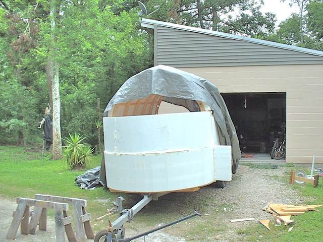

Re: FoamStream...
Postby GPW » Sun Jun 16, 2013 10:18 am
Second panel on ... and it fits ... :o (even a blind monkey sometimes finds a banana :D ) keystone in and not trimmed yet ... there will be “blending “ ... ;)

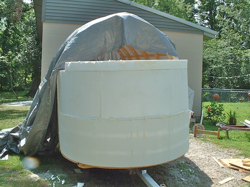

Re: FoamStream...
Postby GPW » Sun Jun 16, 2013 11:29 am
Thanks Ned !!! :beer:

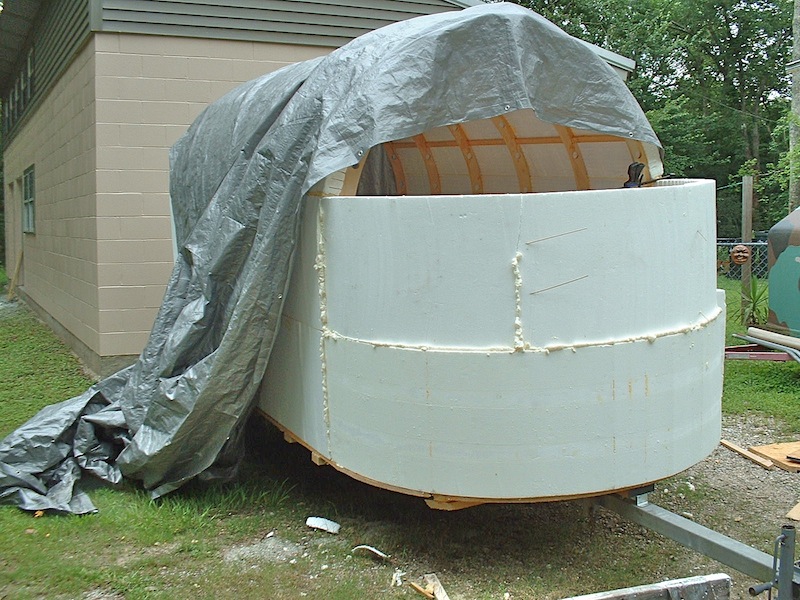

Here’s the first “ring”... the plan is 10” wide rings glued atop one another ...overlapping 5” on the previous...till we reach the top ... :thinking:
Ps. got my 18oz.canvas ordered ... 20yds ... that should be enough , with a little left over to paint on ... :D 8)

Re: FoamStream...
Postby GPW » Sun Jun 16, 2013 11:58 am
...got another ring glued up .... and then it started to rain ... :o :rainy: Time for a shower and a little Nap ... :beer:

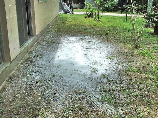

...and speaking of kerfing ... the mess... :frightened: It ain’t snow !!! :o
