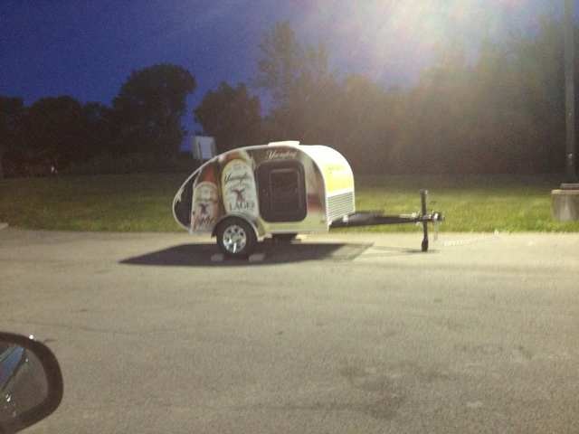

Postby Ned B » Fri Aug 02, 2013 8:02 pm
Inspiration two ways
Ned B
Posts: 1036
Location: Syracuse NY (ish)
Re: Hybrid Foamie: Wild Wanderer in Foam
Postby GPW » Fri Aug 02, 2013 8:20 pm
:thumbsup: 8) :D :beer:
