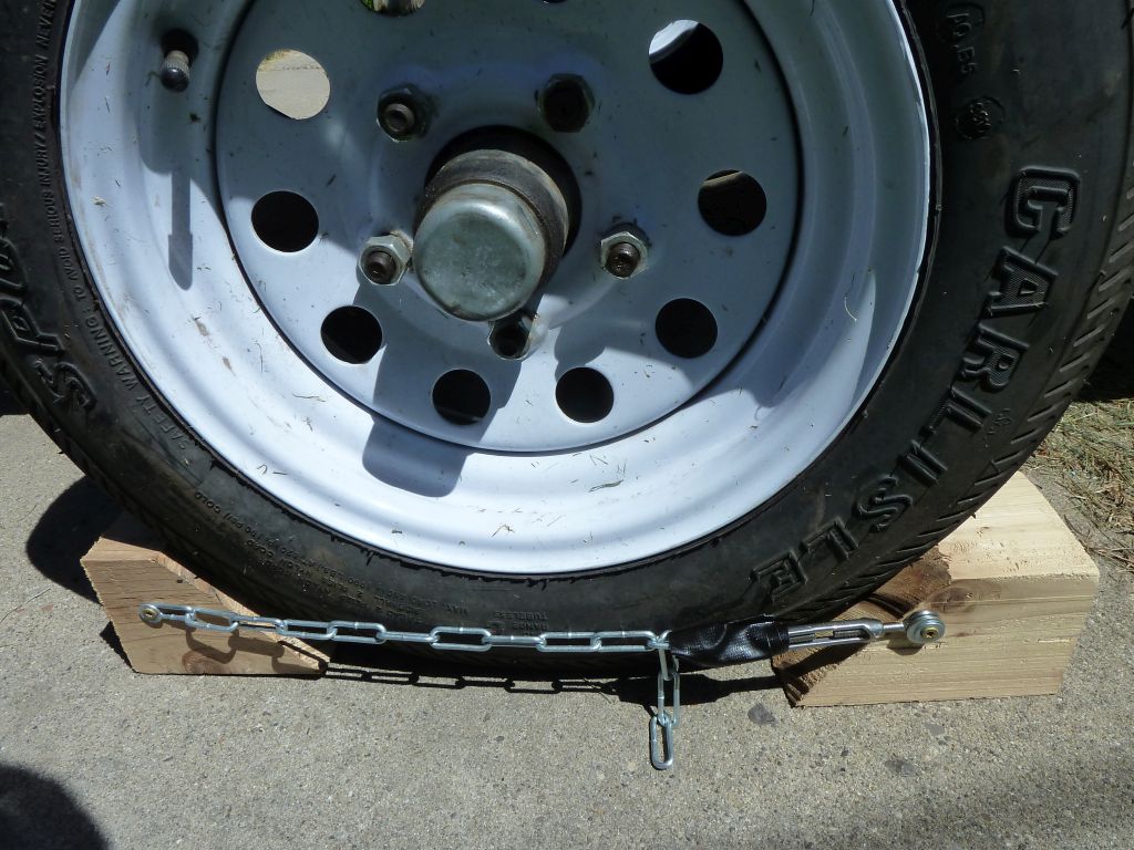

Got annoyed at the chocks I was using and decided to make 2 sets myself. Someone out there may find these useful & they were cheap & quick to build. 4x4, Chain & turnbuckle on one side and a bungee on the back side, so goes on quick and stays put. Gorilla taped the turnbuckle after the chocks were setup tight.

Welcome. Neglected to say, the bungee cord is a standard one with hooks & connects to a protruding screw on each backside wood block -- placed so the cord is somewhat tight. There is almost zero wiggle room so the trailer is solid.

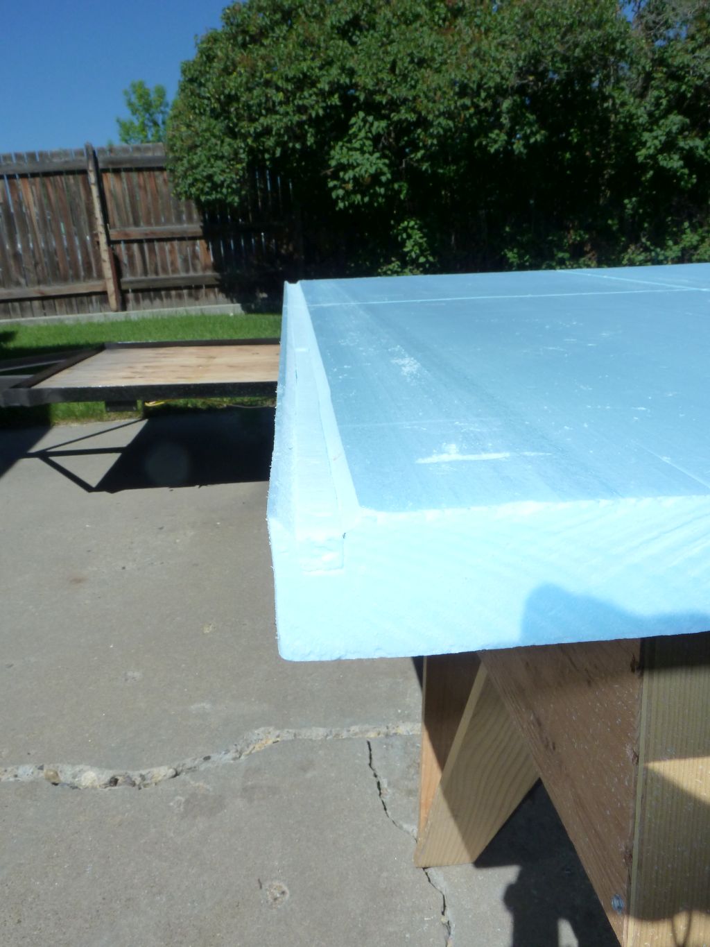

Edit: couple of pix of the work on the roof. Decided to route out a drip edge channel that can be canvassed over & tried the fill with a piece of foam strip technique suggested by KCStudly, which works great.

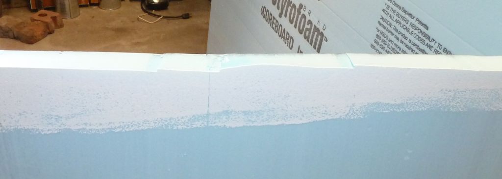

Best of my Bloopers Chapter One
Nice edge - needs remedial buffing - trimming I mean. Yeh, trimming, that's the ticket !!
Blooper 1.jpg (109.66 KiB) Viewed 2467 times
While the one side of the door was on the mark, the other side had a mind of it's own ... was only off by 1/2 to 3/4 inch - will buff out
Blooper 2.jpg (33.31 KiB) Viewed 2467 times
Noticed the edge was going one way while the trailer was going the other, so crooked Pay no attn to that broken edge from the screw !
Blooper 3.jpg (179.78 KiB) Viewed 2467 times

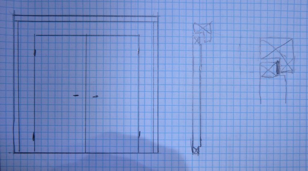

Would like some help / suggestions on how to build my rear swinging door(s).
Total inside width is 49+", and I was thinking of putting a few inches of foam, then gluing a routed 2x2 frame around the opening and covering with canvas overlapping the wood.
Door(s) was going to be built from wood framed foam all around the perimeter (w/wood block lock inset) 1.75" thick to allow room for gasket. So, one door or two ? (was going to do two). If two doors should I put in a central post for more positive pressure on gasket & easier lock setup ? Was planning on normal SS entry door hinges applied on outside surface or mortised. Have no clue which would be better.
Thanks for any help at all - never built anything like this before.

Maybe just some toggle bolts on one door to keep it shut, to close the other door against , no center post needed , or likely wanted... :thinking:
Re: Bread-loaf build thread
Postby KCStudly » Thu Jun 11, 2015 7:05 am
Yeah, just a backer on the inside edge of the door that you would always have to open last and close first. Maybe over toggle clamps or draw latches to securely pull that closed into the seal, yet still allow easy adjustment of the seal compression.
We have that style of cabinet doors in our home kitchen and it takes a little getting used to. You can't just open the left hand door. When you want something in the left hand side you have to open both doors, and then you have to close the left door first; so make sure that you prioritize the things you will want most often in to the side that opens easiest.
On the hinges, although a little more complicated to do with the canvas skin (you probably won't be able to get the canvas to flow into a hinge mortise), I like the idea of mortising the hinges because it goes a long way toward maintaining alignment and supports the hinge from twisting on the screws. This may not be an issue for such a light door, but you never know who's going to hang on them like a big ape. In theory at least...

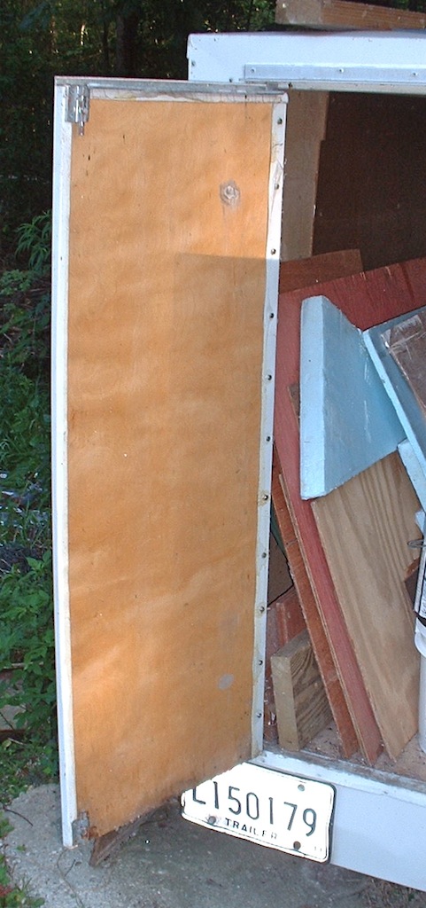

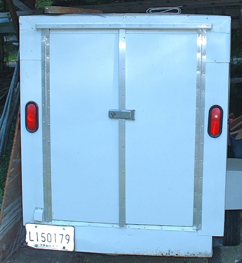

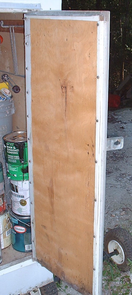

just FYI , here’s a pic(s) of the doors on our All steel cargo trailer ( now being used for storage ) ... Really simple and it works Fine ... :thumbsup:
Note . on our FS door we didn’t mortise the hinges , but did have to put a strip of thin foam sealer along the hinge line to keep the weather out ..... No problems so far ... and it’s been through some torrential rain storms already , no leaks ... :thumbsup:
On Foamie #1 ( Now “Nookery”) , the door hinge is on the outside , works fine ... 8)

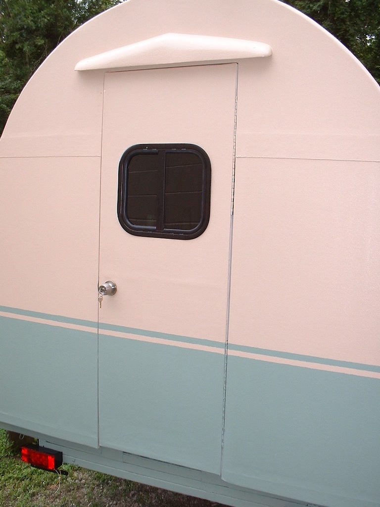

Postby GPW » Thu Jun 11, 2015 7:53 am
FS door pic ...

Postby Fred Trout » Thu Jun 11, 2015 8:55 am
Thanks for the great ideas. OK, two doors, put on canvas first, SS piano or knuckle hinged applied on top of canvas (might get a mortise underneath canvas to work with depression passing thru - will test), no center post needed, Toggle bolts to hold inside door, some swivel lever action lock to hold outside door, inside positive stops with gasket are ok, including one on lock side of toggle closed door.
"Garage" Lock perhaps like this one that can compress as it turns
What do you call that outside edge molding, GPW ? gotta know what to look/ask for

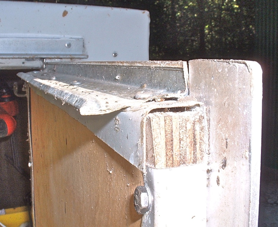

Postby GPW » Thu Jun 11, 2015 9:22 am
You know , that’s a good question... :thinking: But here’s what it looks like up close (see pic ) ... seems a simple combination of things, looks homemade :o The middle seam is just a piece of AL flat bar stock .. .... the "old man" (somebody’s Dad as we heard it) that made the All Steel Cargo Trailer was pretty ingenious ... Clever fellow ...  it’s a STOUT trailer (built like Army Tank) , and a bit heavy ( all steel eh ? )
https://www.youtube.com/watch?v=FkyVQTX9CbU We thought this was pretty “close” .... just sub foam for the inner door and skin the outside , everything else is pretty applicable ... :thinking:

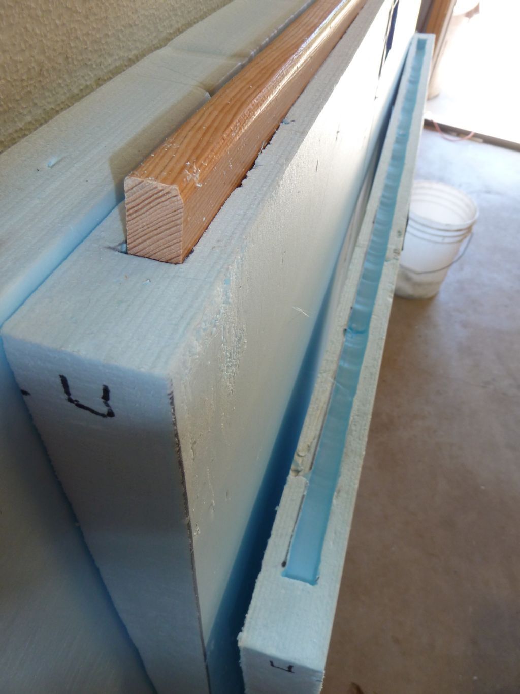

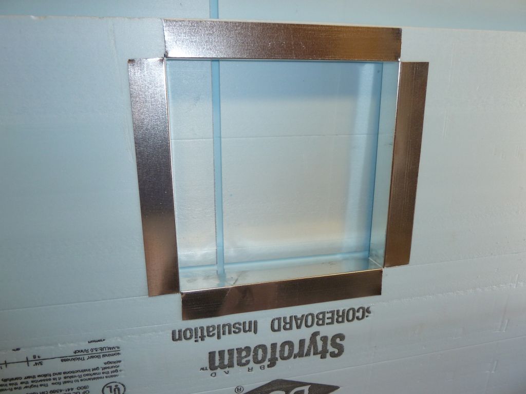

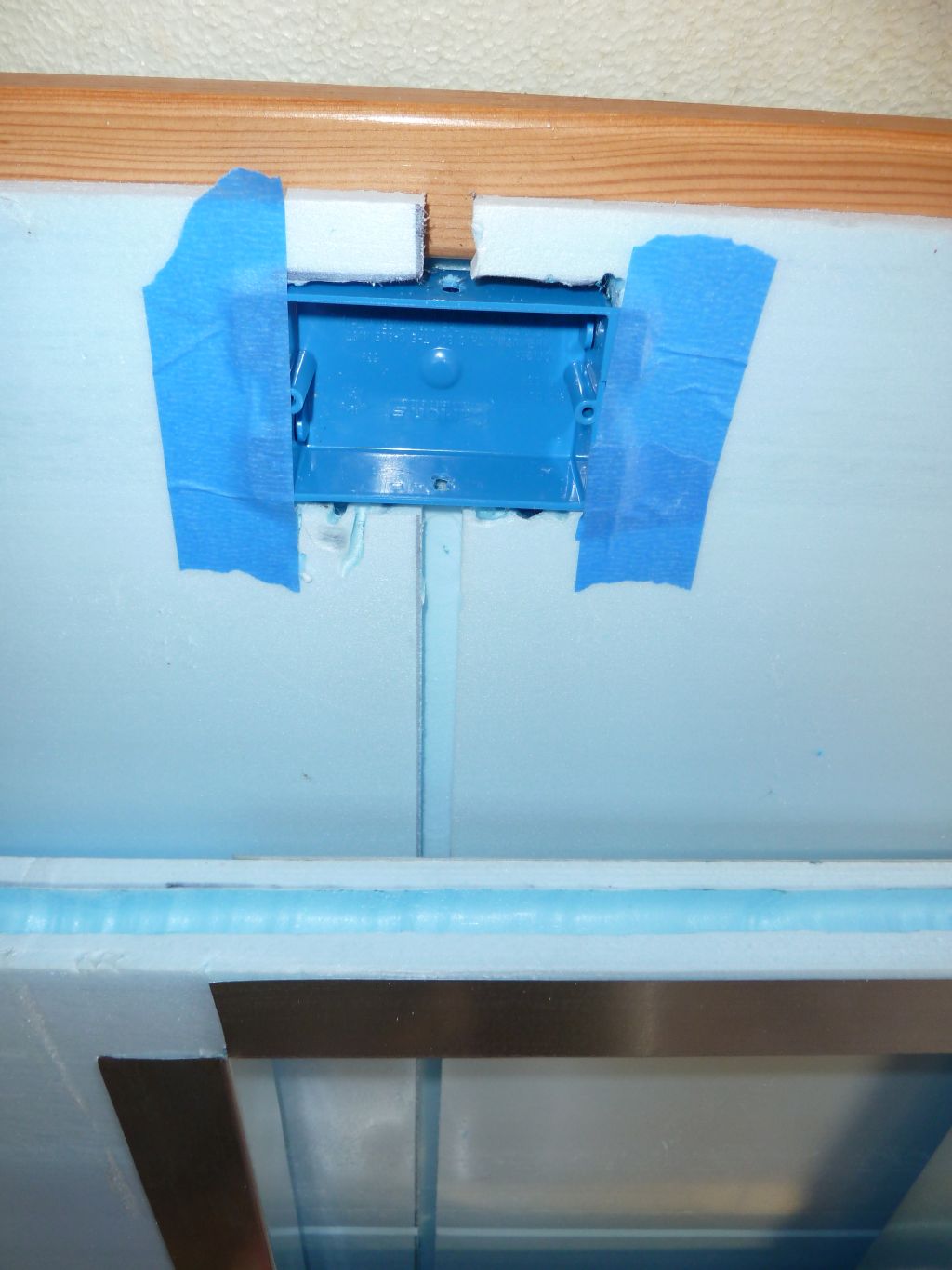

Got the roof panels closer to completion:
- panels cut to finished size
- roof support spline completed (hot wire cut)
- electrical box for fan & LED light drilled & glued in place
- fan cutout completed & flashing support roughed in - still needs to be final fitted, secured in place w rivets & gripper
- sides ready for final fitting & dry-wall guide screws roughed in
Lots of Pix:
Spline egde view.jpg (145.22 KiB) Viewed 2324 times
Roof Spline & Elect Box.jpg (145.38 KiB) Viewed 2324 times
Fan cutout flashing.jpg (100.16 KiB) Viewed 2324 times
