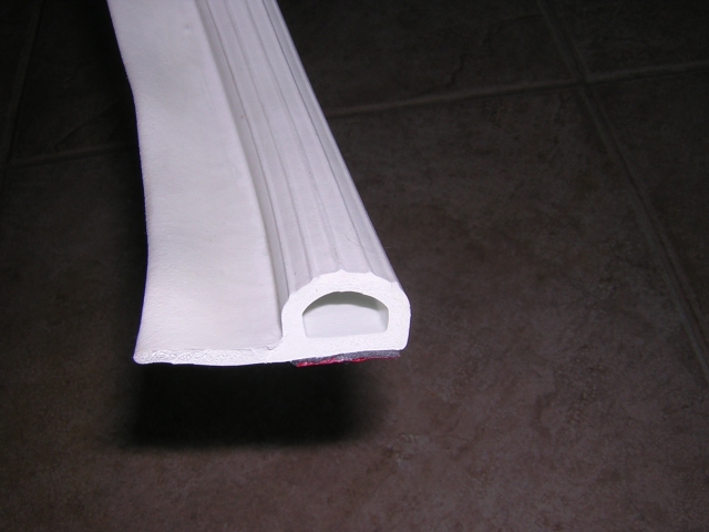

Postby S. Heisley » Fri Sep 08, 2017 7:20 pm
I can see the latest pictures!!! I can see you, standing inside, with the top up!!! Oh, Wow! Thanks for fixing it!
I'm not clear on what your problem is with worrying about the wind lifting the top off. I would think that good clamp locks in strategic places and maybe some strapping (Maybe ratchet straps to start with?) would solve that problem. But, then again, you are dealing with foam, which could make everything work a tad different.
Now, as far as air getting in....If air can get in, so can water, sometimes :thinking: But, if the air space is like a vent, it might not cause a problem. Maybe try it with a small sample and a hair dryer on cool air to see? Weather stripping might help but the normal kinds might scrape off. I'm testing the type below on my lifting wall areas and have had fairly good luck so far. I say "fairly" because I didn't get a good attachment the first time I put it on and it slowly slipped off. But, I think I didn't clean the area well enough/still had some oil on the surface. The second fitting is working okay, so far...:
https://www.amazon.com/Weather-Strippin ... +stripping
The above is for regular doors and windows without sills and is similar to garage door weather stripping; so, if you need something wider, take a look at something like this:
https://www.amazon.com/M-D-Building-Pro ... rage+doors
...Just a thought.

Postby S. Heisley » Sat Sep 09, 2017 7:41 pm
dancam wrote:
S. Heisley wrote:I can see the latest pictures!!! I can see you, standing inside, with the top up!!! Oh, Wow! Thanks for fixing it!
...Just a thought.
Can you see post #76 from sept 4? I went back and edited the older photos so they should be visible now. If you can see that post youll see the ratchet straps i have to hold the top down and why i need shims of some sort to keep it from rocking still.
With the air getting in, what part of the trailer are you referring to?
Thanks for the links to the weatherstripping :)
Okay, yes, I see them and that should help a lot. If wind comes up, it's going to sound like a bunch of didgeridoos, though. (I speak from experience. The wind will play those straps like bass guitar strings and it will be very noticeable, more so inside.) A trucker gave me a trip that helps, though. He told me to twist the straps like a licorice strip and it will cut the noise. He said that's what the truckers do.
:thinking: As far as the gap goes, you could use some foam weather stripping but remember that wherever the foam weather stripping is a tight fit, it may peel off. Still, adding a foam strip on the inside edge of that gap, if you have room, (They make several sizes) would help keep down the back and forth action that you're writing about, as well as cushion the sides where they overlap/gap. The other weatherstripping that I mentioned would go along the bottom edge, with the flap part going inward to give you a decent seal against rain, etc. I don't think it would hurt the trailer to try it; and, if you aren't happy with it, all you'd be out is a wee bit of money. You might also try adding a thin strip of wood there; but, you know your build better than I, and would know if that would work. If there's room, precut door stop wood strips might be the key. (They make a couple different thicknesses and sizes of that, too.) Or, maybe just a strip of your thinner Styrofoam at the over-lap area?
I hope that all makes sense. Sometimes, it's kind of hard to explain just with words.

Postby S. Heisley » Sun Sep 10, 2017 8:07 pm
The gap is 1inch wide all the way around and the top overlapps the bottom by one inch. That 1inch overlap should keep out any and all rain. Do you think so or not? If not i just cut the verticle supports another inch shorter so it overlapps 2 inches. A 1inch gap is a bit big for weatherstripping but your right-shims will squeak. I think i will have to do some experimenting, so thanks for the ideas. I will try a few different things to see what works best probably after i finish this tongue box and doors. The foam would probably squeak too, hmm...
Okay, the 1" overlap may be good for keeping water out but cold air coming through the 1" gap could make it pretty drafty. But, that 1x1" overlap x gap may be to your advantage! This is because you can get 1/2" thick and wide foam weatherstripping. So, if you put a strip of that at the very top of the outside side of the stationary "box" and a strip at the very bottom of the inside side of the lifting "box" so that they meet like two fists knocking on each other or maybe touching but not scraping each other, it might work. Here's one that you could tack or glue on; but, you'd have to use a couple pieces to make your length:
https://www.amazon.com/Frost-King-AC41W ... atherstrip
There are other types of foam weather stripping that don't scrape or make noise. The problem is that the sellers don't usually give all the measurements or they give them but don't say which is width and which is thickness. Your best bet may be to go to the hardware store and look. Your good fortune is that hardware stores usually restock this stuff in the fall; so, you should have a good selection of products to look at. Foam weatherstripping doesn't make much noise, if any, when it rubs. It isn't like Styrofoam. But, remember, if it rubs, it will likely come loose or even off.
Post script: There is one other kind that you might look at. It's expensive and you have to go to an RV supply store to look at it. It's used for pull-outs on RVs. I used it across the front of my lifting roof to give me a little extra protection from wind-driven rain. I had to tack it in on each end to keep it from wanting to come loose. That did the trick. It doesn't make scraping noises.
