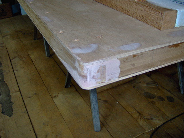

Anyway, after picking up the Jeep I trekked out to Mecca and started by doing some pickup spackling on the street side wall. It seems like I keep finding divots in the ever changing light; need to put a work light on the subject.

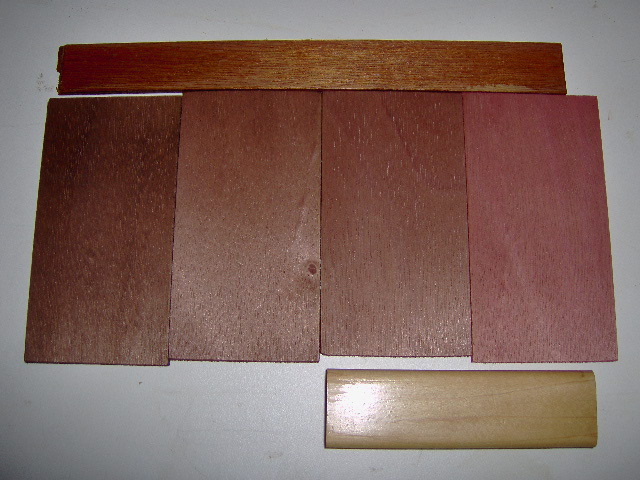

Sharon, I’m looking for a nice even medium brown color with an undertone of red, or even purple, but I want it to be an earth tone for sure, and a good contrast to the natural light color of the maple. The grain in the Okoume is fairly subdued and it takes color fairly evenly. I don’t really want the grain to “pop” (like oak), but I don’t mind a bit of character, either. What I really want is for the application of the finish to be simple, consistent over large areas, and, I am learning, agreeable under varying light conditions.
I’m going to have enough of a challenge dealing with the poly and getting a nice finish there that I don’t want to have trouble or second guesses on the color.
I ramble. :wine:

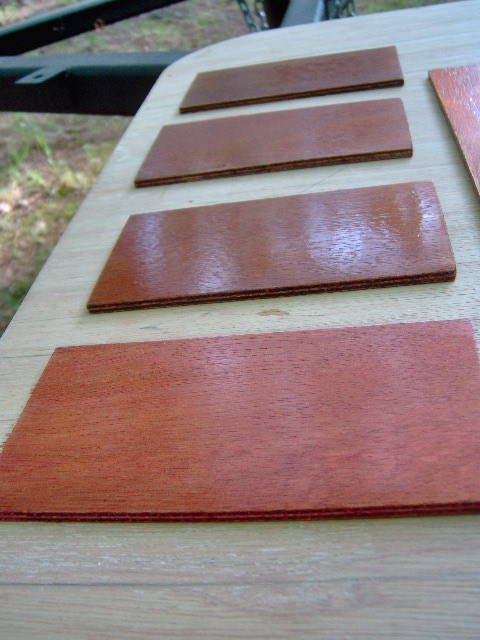

Like I said, the test pieces looked completely different under different lighting and the one we all thought would be “the one” now looked like pale salmon, as if the brown had all but faded out of it.

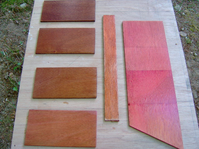

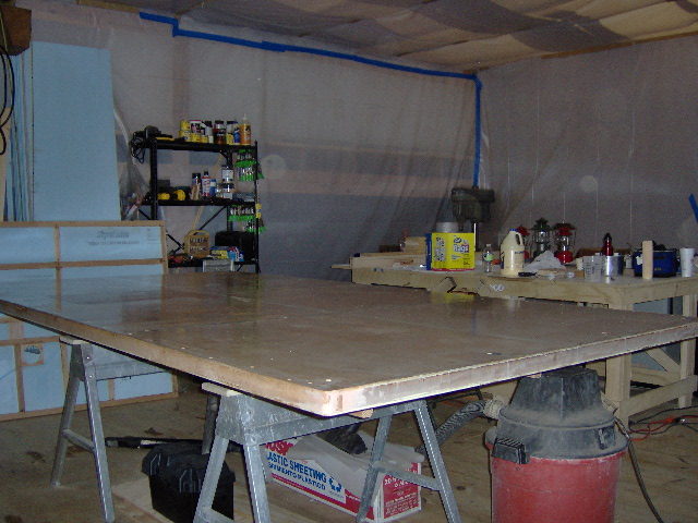

Friday now. Got some bubble wrap today, the kind with the small bubbles, to eventually be used vacuum bagging the inner wall skins.

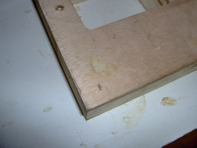

Sanded street side spackle again. Scuffed the first coat of poly on all of the color samples with 320 grit and put another coat on.
Aligned the street side wall to the underside of the street side of the floor, laid out the screw holes for same, and drilled the countersunk holes (partially). The deck screws that I thought I was going to use ended up being a little short, so I need to make sure which screws I am going to need before finalizing the countersink and thru hole diameter.
Then I did a little more pick up work on the spackle. I just don’t know what the canvas will hide and what will project thru, so as they say, “the final coat is only as good as the prep work”. I hate body work, but the spackle is very light and sands very easy.

I’m sure that the light is playing tricks on me, but I also am pretty sure that the color changed on the samples. The 4:1 red over brown that looked so good now looks pale and a bit too pink.
I went ahead and put poly on all. No flash, outside natural light at twilight.
Same thing, different angle.

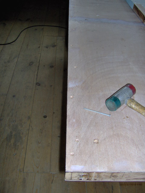

My DeWalt countersinking/pilot hole drilling/quick change screw driver bit tool only drills a pilot hole for the screw. I used that to start all of the holes in the underside of the floor where the screws will go up thru into the bottom of the wall sill. For strong structural joints between the floor and wall I wanted to make sure that the joint pulls up tight, so I needed to drill out the floor side of the hole to be a clearance fit with the shank portion of the screw, otherwise the screw might not pull the two surfaces together if it were to bite on both sides of the joint with a gap in between.
The counter sinking bit and drill didn’t go all the way thru the floor, which was fine. I used one of the coated deck screws as a gauge to make sure the countersink was the correct depth, and a quick square as a guide to drill the holes relatively plumb. Then I used a scrap piece of pine clamped on to the top side of the floor (floor is bottom side up in the pic) to help prevent splintering as the larger clearance drill broke thru.
I love the smell of the cedar when it is worked.

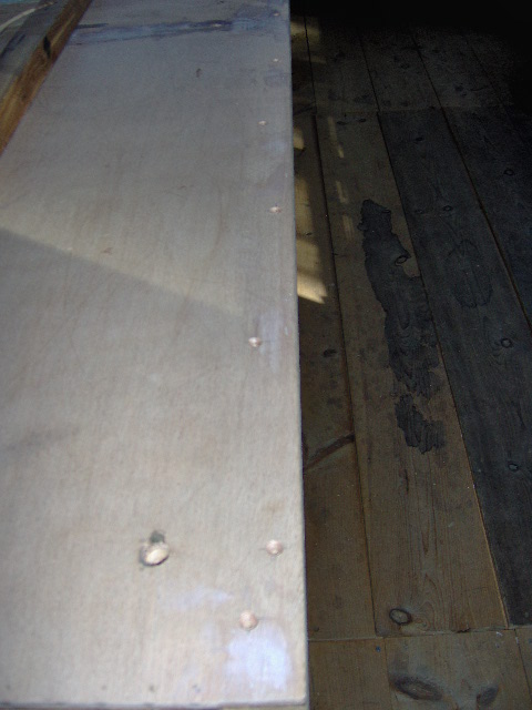

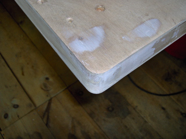

Then I switched over to the curb side wall and laid on the first application of spackling.
Back to the screw holes. The drill I selected for the clearance hole was right about one-for-one on the screw (I wanted to keep the bearing area under the head of the screw as large as possible), so I went around with one of the screws and tapped it into each of the holes to clear all of them out just a bit (on a couple of holes I had hit the staples that were used at the edges of the skin panels).
Also note in this picture of the back of the floor where you can see the biscuits that were used to assemble the floor frame. There are a couple of small void spaces where the biscuits didn’t fill the slots completely.

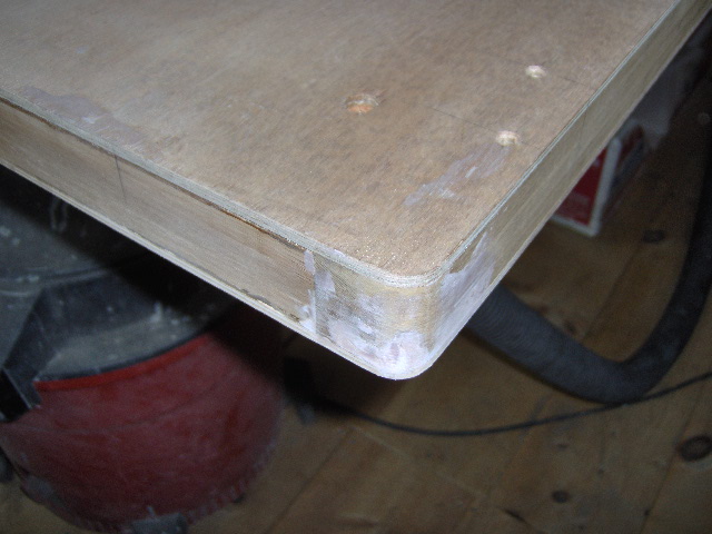

At the front of the floor I had used the jigsaw and hand sanding to form the radius in the subframe. The shape did not come out plumb so when I routed the upper skin (bottom in pic) using the bottom skin (upper in pic) as a bearing guide it left a little ledge between the skin and subframe. I mixed up a small batch of polyester body filler (Bondo) to fair this and the biscuit voids in. It took two thin applications.
First go ‘round.
Final.
I haven’t decided if I need to ease the bottom edge for the canvas to wrap under. I don’t want to “celebrate” the joint between the cabin and trailer frame, yet the trailer frame already has a radius on its top edge; call it a drip edge/shadow line.

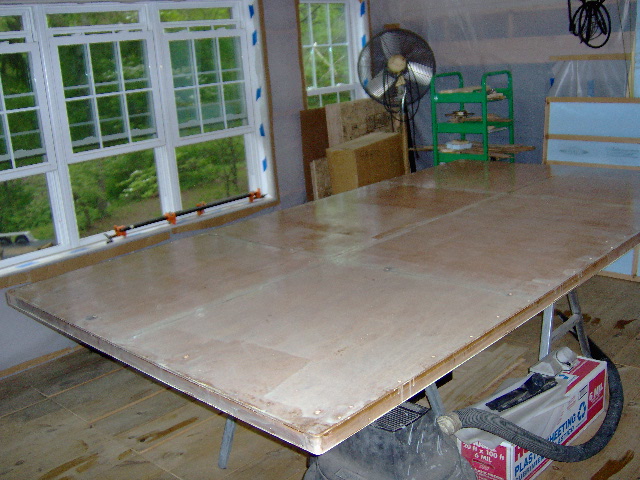

Forward progress. I seem to be getting about 2, maybe 3 hrs. in on the week days, and maybe 4 hrs. per weekend day lately.

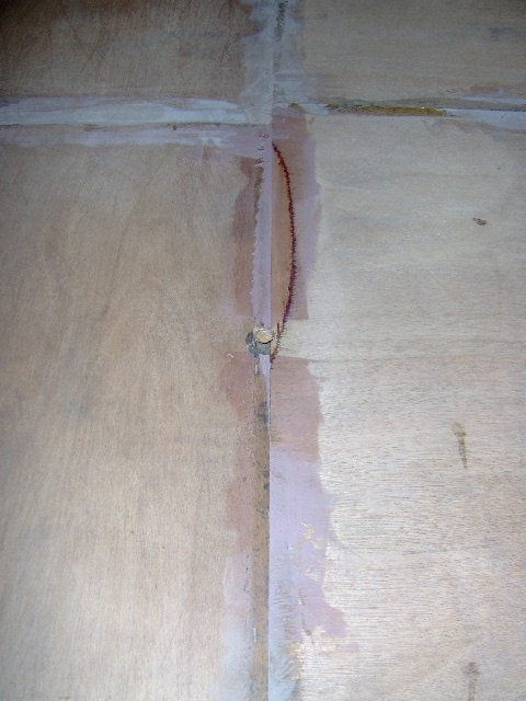

I started by sanding out the first coat of spackling on the curb side outer wall, then stuck another coat on before standing that up. (No pic.)

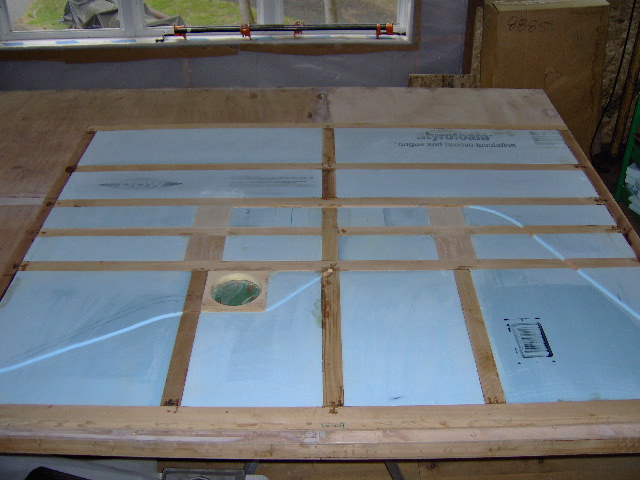

Next I wanted to seal the underside of the floor, but when I got it all cleared off and swept clean I realized that I still had a couple of staples to be filled in that area where I had to shave the joint down a bit. So I mixed up a walnut sized wad of filler and skimmed it in.
While that was setting I got the bulkhead out and sanded the back side to level the foam and the wood.

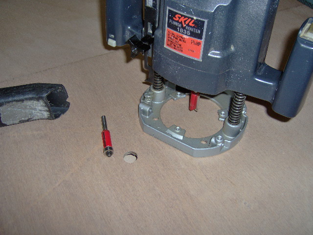

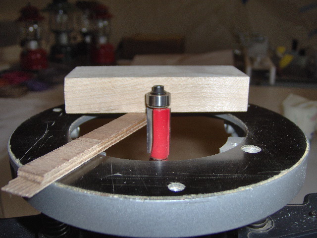

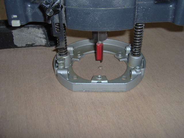

Before flipping the bulkhead I drilled a locating pilot hole thru the middle of the bulkhead fan register.
Here is the pilot hole on the cabin side after flipping the bulkhead and just before plunging the router thru to open up the hole.
I set the plunge depth on the router so that it wouldn’t go so deep as to damage the floor, and plunged thru the pilot hole. I just sort of walked that around free hand to open the hole up for the flush cutting bit.

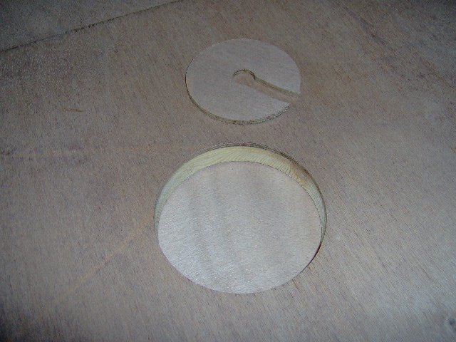

Then I switched to the bottom bearing flush cutting bit (so that it could ride around on the blocking opening on the inside) and set the depth stop on the plunge router so that it would make a full cut without the bearing retainer bolt riding on the floor/table below.
The cut went very well.
