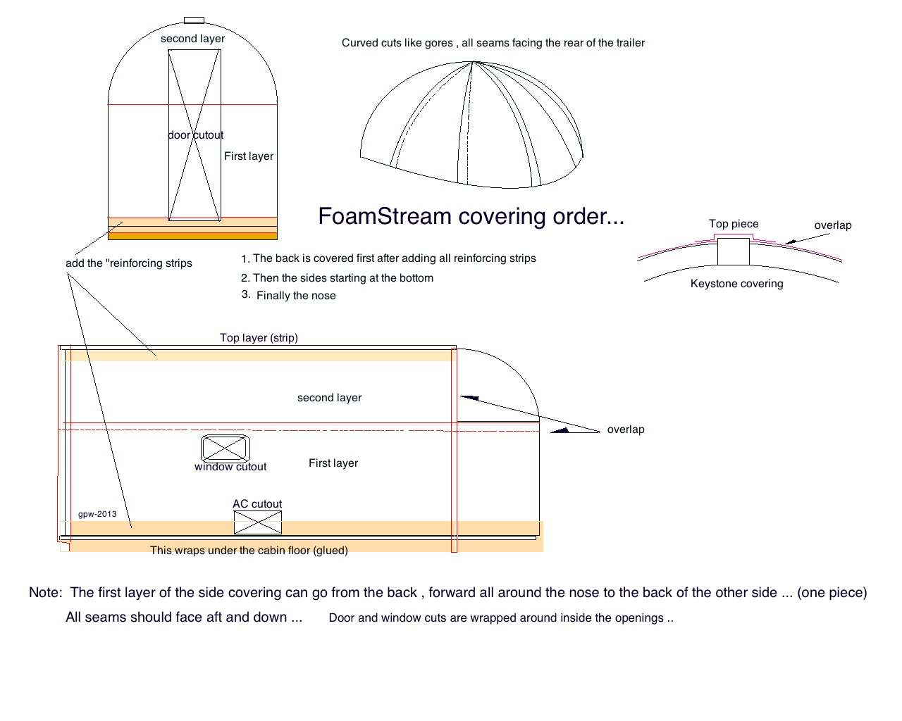

Postby GPW » Sat Jun 29, 2013 7:39 am
Since we’re getting around to covering (and it’s raining again :rainy: ) Drew up a covering plan (Yes, another drawing :o )...The outer skin is one of the most important parts of a Foamie, and done right should be trouble free for many years ...
Ps. we will be using a chalk line for accurate canvas layout and straight seam lines ... :thumbsup:
