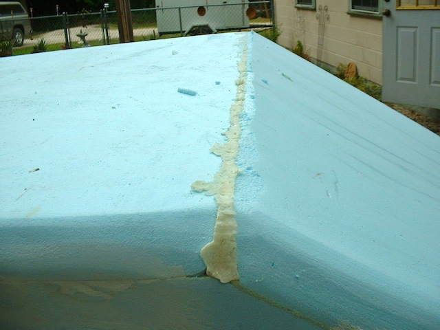

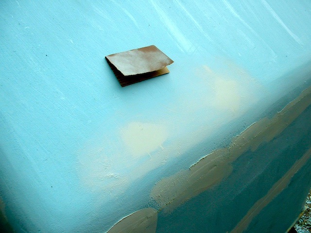

I just knew this Had to come up sooner or later ... :o Last night I used common spray foam to fill in the gaps in my roof , and used vinyl spackle on the dents ... Both worked Very well .... the foam expanded and sealed the roof , this morning I cut off the excess with the recommended serrated knife and will just have a little sanding to make things flush and ready to cover...
The spackle is still a bit soft (rainy/Humid here), on the thicker areas , but the thin areas , just sanded smooth very quickly ...

The roof seams have yet to be sanded , raining now ... but dried in ... :D Having not yet covered the TD or encountered any Bears (or Alligators) , we unfortunately have No pics of a repair... yet...
