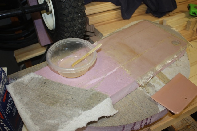

Postby mikeschn » Sat Jun 11, 2011 9:35 am
Can anyone venture a guess as to what weight this fiberglass is?

Postby mikeschn » Sat Jun 11, 2011 12:17 pm
I'm playing with epoxy this morning!
I've used epoxy on fiberglass and canvas!
I have to let the resin harden overnight, so I should have some preliminary results tomorrow morning!
Postby GPW » Sat Jun 11, 2011 2:14 pm
Mike , I can see where a perforating tool and epoxy would make one STRONG skin ... canvas or fiberglass ... thousands of little epoxy "nails" deep into the Foam holding the skin on... Just something else to try on scraps ... :thinking:
