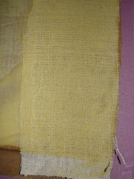

Postby dogeron52 » Sun Nov 13, 2011 5:15 pm
well I started my fabrics project today. I discovered that gatorboard I believe is foam covered with Kraft paper. and you can get different thicknesses. So I took 1 1/2 in foam board and tried to cover it with kraft paper,then start covering that with fabric.I have a bed sheet, muslin,duck cloth canvas,burlap, and some plastic fabric that i used on a seat for my bike it looks like screen for windows only thicker. No idea how this will work out but I am taking video and pictures. I will post when the glue dries.
dogeron

Postby dogeron52 » Sun Nov 13, 2011 6:21 pm
from early tests plastic fabric is out obviously.It wouldnt stick as I thought because the glue doesnt permeate the fabric. The kraft paper underneath worries me that it pulls up rather easily. (no puncture marks for glue intrusion) Maybe I am overthinking this as I dont have any fabric or the paper completely around the structure sealing it. I like the canvas,muslin,bed sheet and even the burlap. pictures to follow.
Dogeron

Postby dogeron52 » Sun Nov 13, 2011 10:32 pm
pics of fabrics with TB2.

Postby eaglesdare » Mon Nov 14, 2011 6:39 am
yes, the fabric WILL come off, it will peel without too much work. however, it will be wrapped. "THE SOCK" effect. no need to worry about that peeling or lifting.
sort of like "the hammer". a hammer to the foamie might do some damage, but are you really going to use a hammer on it?
so since i am not going to (on purpose) peel my fabric off, i am not worried at all.
