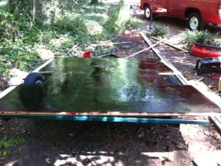

I was told in boot camp, "The maximum effective range of an excuse is zero" but I have a few any way. My grandmother died on her 96th birthday, my stepfather had heart attack #3, I worked 33 hours in a 48 hour period (yeah, overtime!), and I broke a tooth. All in a week! Still, I think I am making progress (instead of sleeping). Behold, a floor:

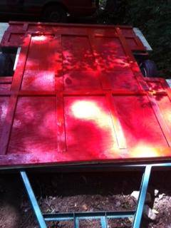

It's bolted down with a dozen and a half of 1/2" carriage bolts, through the C channel of the frame. And I also painted it red, because I was trying to use up 2 quarts of old paint I had:

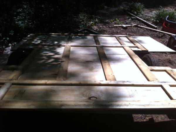

And lastly, I filled the voids with 1" foam and covered that in masonite, held down with a bajillion wood screws and covered liberally with evil balck goo:

By the way, I flipped it over before I bolted it down. The Mrs. would not take kindly to sleeping on tar! :lol:
