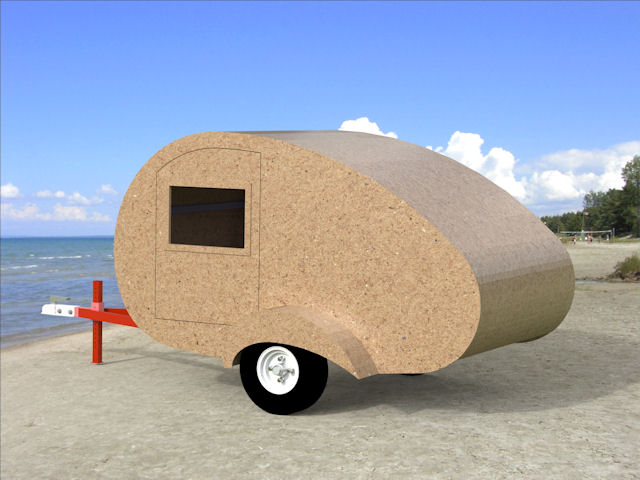

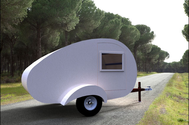

Ever wonder what an unfinished cardboard teardrop would look like...
Here ya go, Andrew's Pico in cardboard!!!
Just for fun, here it is in Aluminum...
