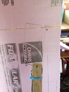

I made this one in about 15 minutes using a piece of scrap pine, a file folder, a couple of screws and zip ties, and the 2 amp transformer from an old printer. And I do mean old!
Cost: 15 minutes of my time. Works like a dream.

Re: Electric styrofoam knife
Postby Treeview » Tue Feb 28, 2012 12:49 pm
Printer transformer...thanks...off to scour the dumpsters!
Postby Papi » Tue Feb 28, 2012 1:09 pm
Treeview wrote:Printer transformer...thanks...off to scour the dumpsters!
Just make sure the one you get is pretty stout; the first one I tried from an old answering machine didn't heat up. It was measured in milliamps. The next one I tried was a bit stronger, but the solder melted off the inside of the transformer and I had to unplug it in a hurry! :shock: I got a big pile of old transformers free, so it didn't cost me anything but time. I bet even a car battery would work.
