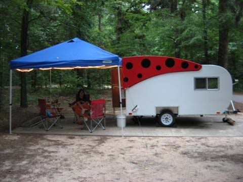

Here are two examples of 5mm, ¾ foam, 5mm sandwich framed campers. As you can see, they are quite a bit larger than a traditional teardrop – but more important is to look at the weights – both were weighed at certified scales
starleen2 wrote:Finally, the top hinge is now sealed and functions just fine. Stopped in at the county office and registered the camper. Did a test tow down the road up to 70 mph and pulls just fine. Even stopped by the scales and got the whole thing officially weighed – 950 lbs! Now to go camping :thumbsup:
Build thread
viewtopic.php?f=50&t=27592&start=150
starleen2 wrote:Got the Green Lantern weighed today and it topped the scales at 1160 lbs fully equipped and loaded :) . I am pleased how it towed and how it turned out - Thanks everyone for the kind comments :)
Build thread
viewtopic.php?f=50&t=40943&start=210
Just the other side of the question. . . . .
