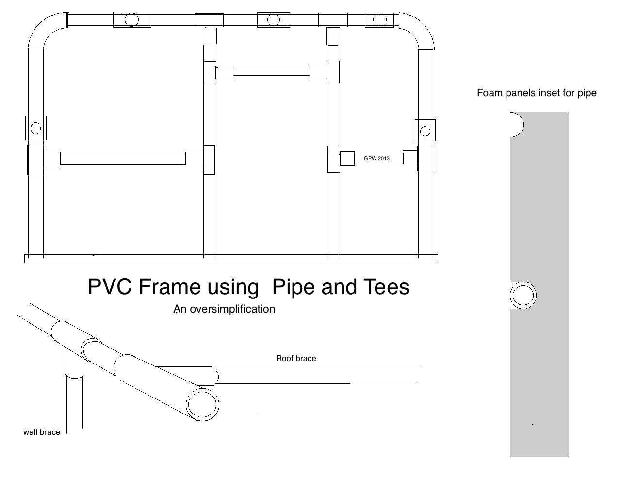

Postby GPW » Sun May 05, 2013 12:44 pm
And just to add to that thought , an oversimplified drawing as an explanation ... and the idea that you could also use the PVC as wiring runs too ... Multitasking :thinking:

Postby KCStudly » Mon May 06, 2013 11:48 pm
My thought is that the std. ftg's would be a big restriction to organic shapes. Also, PVC can be brittle in cold climates.
Could work, just not for me.

Postby GPW » Tue May 07, 2013 6:02 am
Hmmm? perhaps ? The fittings were just one example of what “could” be done ^ .... For The COLD regions , use the gray PVC ... ;)

Postby Fred Trout » Thu May 21, 2015 10:45 pm
The trouble with pvc pipe is when round meets square. It's pretty hard to actually connect the pvc to the required structure it is intended to support without too much fiddling.
