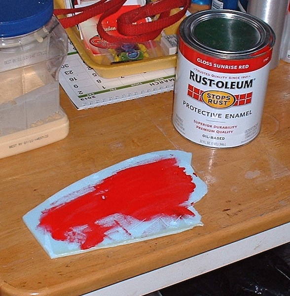

Has anyone used Tremclad over the TB2 and foam?
(I have some already)
Did it work OK or will I have a big blob of melted chemicals?

OK, that’s Rustoleum for us ... and no I don’t think I’ve ever heard of anybody using over foam either ... not that it might work , and like everything else , be tested on a bit of scrap first ... ;)

Just a WAG... if Rustoleum/Tremclad is an Enamel , then no problems eh ... we’ve used enamels over bare foam before on RC planes .... Schmaybe’ .... :thinking: A simple test will confirm ...
Re: Tremclad Paint
Postby GPW » Fri May 24, 2013 8:57 am
OK, here’s your test .... Passed !!! :thumbsup:

Postby Papi » Fri May 24, 2013 9:18 pm
Wow that was fast! I did a similar test today but I soaked a piece of foam in rustoleum all afternoon. No problem
