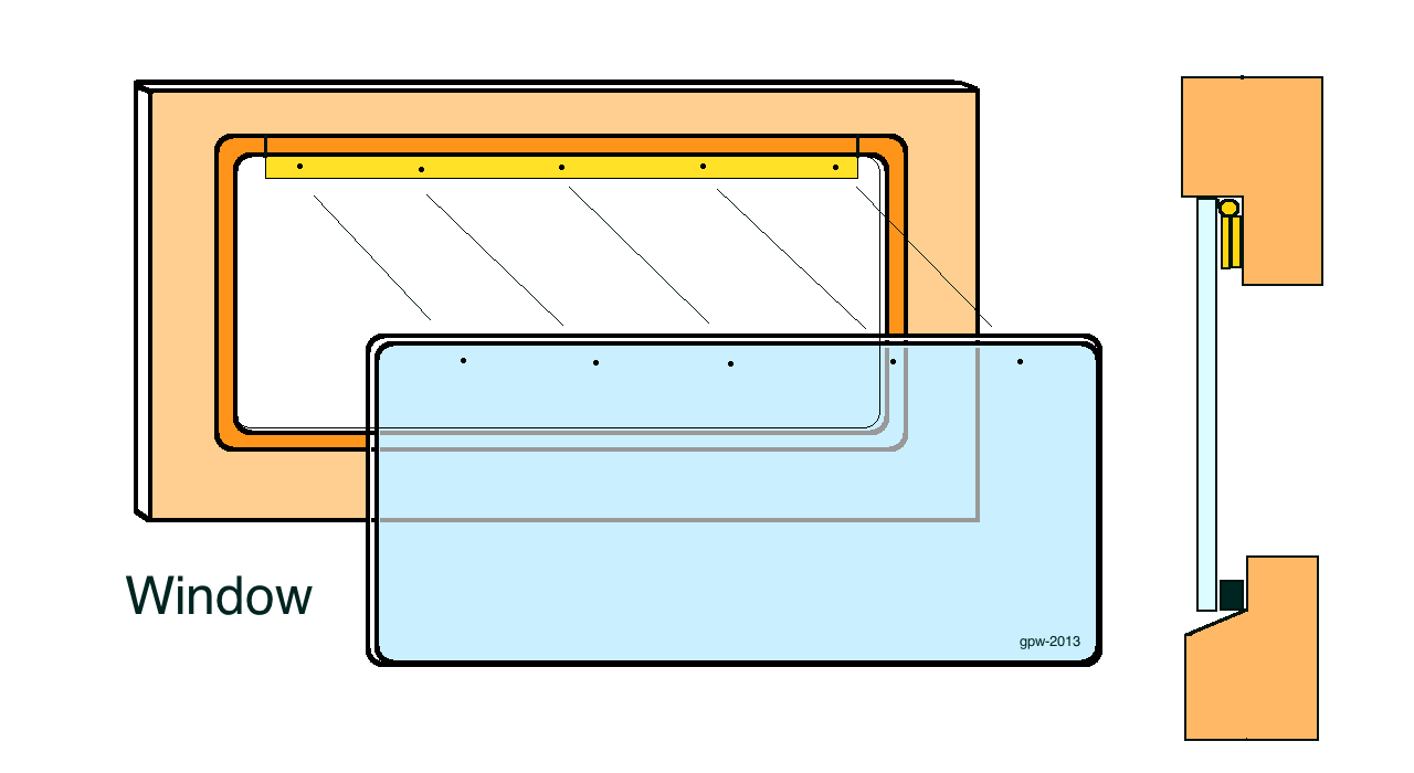

With a CNC available , I was kinda’ thinking about making some simple windows ... :thinking:

GPW, I like that design, pretty simple. Looks like it could be done with a router. ( if I had a CNC machine, I'd use it though. :thumbsup: )
