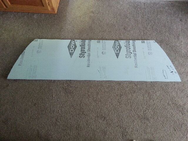

Postby coal_burner » Wed Aug 07, 2013 6:18 pm
The build has begun.
After a whole bunch of research on the curing requirements of vinylester, I've decided to just go with epoxy.
Since I don't have to worry about things dissolving, I can put some extruded polystyrene scrap to good use.
Here is the forward bulkhead, shaped to conform with the rear of the cab.
Im sure it's going to be fun figuring out the curves in the sides, and how they are going to match up with the curved top.

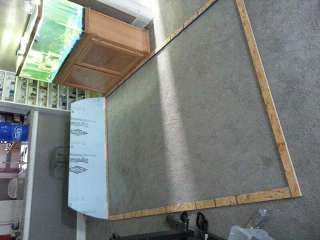

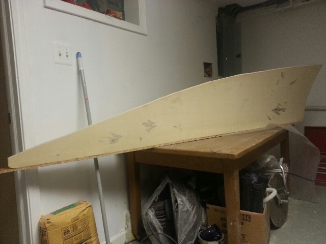

Postby coal_burner » Sat Feb 08, 2014 9:12 pm
the next step has been taken.
2"wide strips of 1/2" OSB have been cut for the mounting rails.
the bulkhead foam has now been epoxied to the front rail
the 2 sides have also been cut & skins removed
things i learned today:
this foam smells HORRIBLE when the skin is peeled off
it is brittle enough that i put a crack in one piece while peeling the skin off
it is fairly soft & wobbly when there is no skin there to keep it rigid
