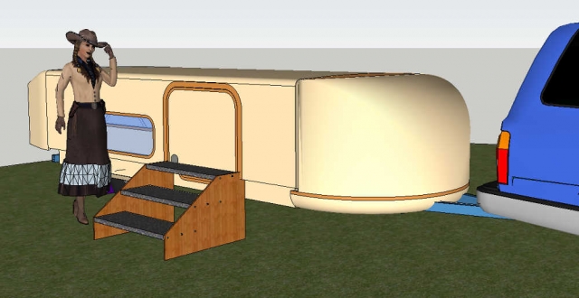

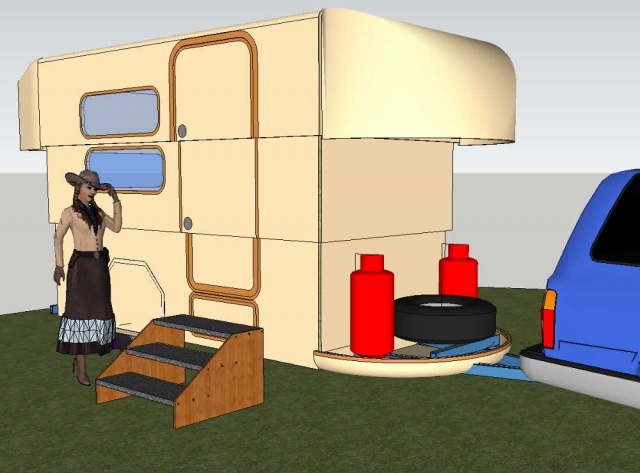

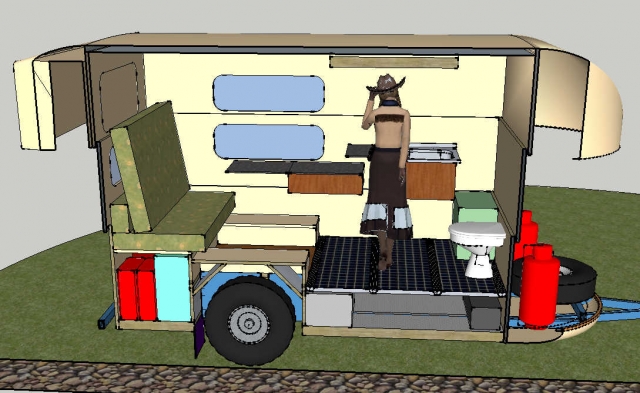

Size wise, I wanted enough room for a queen bad, indoor kitchen, shower, and toilet. Inside it is 5' wide, and a bit over 11' long. Design is still a work in progress. Cowgirl is 5' 8-1/2" tall, SUV is a 4Runner, and tire size is 31x10.5R15 to match my 4Runner and Hilux pickup.
Inside with bed turned into sofa. Also some modules on wall.
Top up.
Top down and ready for travel.

Have you figured out the lift mechanism yet? A three tier lift will be complicated...whew! Sealing each section of the telescope seems a challenge. Not insurmountable, but a challenge.
Since I'm 6'2" a lengthwise bed is the most likely solution. Sideways would be nice but that makes the unit wider. This is planning for wayyyyyyyyyy in the future. I have to finish the ToyBox first! If I do another build I'll probably have to sell the ToyBox to finance it. That would mean being without a camper for the interum. More plannning :)

Three tier lift is still relatively simple. I'll likely be using cables. At each corner there will be a cable. It will have a fixed attachment to the inside side of the bottom of the top's wall. The cable will then go up in the gap space between walls and over a pulley mounted to the top of the middle wall. From there it will be routed through a tube down to the bottom of the middle wall, and around a pulley down there. Then it goes up in the gap space between the middle wall, and the bottom section's wall to a pulley mounted to the top of the bottom section's wall. From there it will be routed with tubes and pulleys to a block that will combine all 4 cables into one. From there it will go to a winch that will be used to raise and lower the walls. As the cable is pulled on, the only place it can shorten is in the gap areas between the walls. That will lift the walls. I expect I'll have to have turnbuckles on all 4 cables to get them tensioned the same. I'll be hiding most of the cable routing inside the basement area, and only have the winch positioned on the tongue. It'll need to be far forward in a place that is accessible when the top is down. I likely can find a winch at a RV salvage place, or get one from Farmtek.
