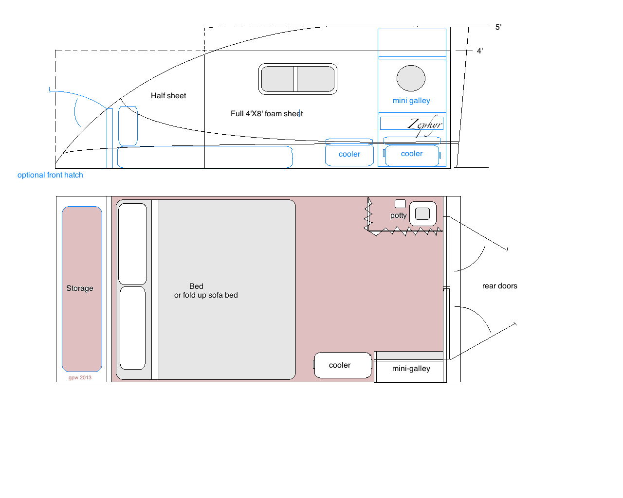

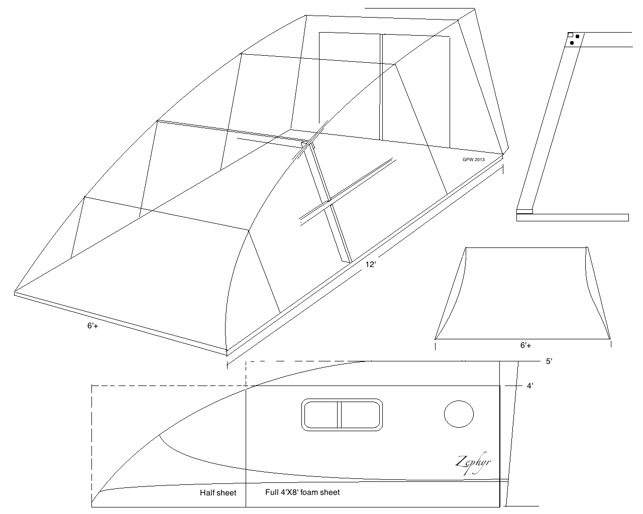

... and now for something different ... Well, not really ... Just some advanced thinking about "what next" ... the eternal Foamling' question ... :roll:
Take a 12' flat boat , turn it upside down , and make it 5’ deep ... and there we are ... Simple , roomy , and somewhat aerodynamic , or looks like it anyway ... another drawing to better visualize the structure ...

Postby GPW » Mon Sep 30, 2013 10:43 am
Inside possibility ... :thinking:

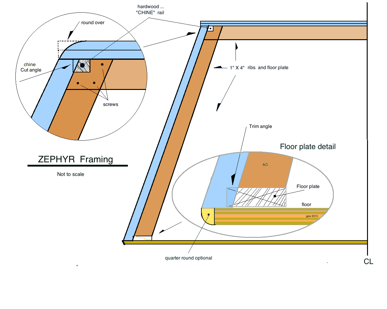

Postby GPW » Thu Oct 03, 2013 9:03 am
Just another drawing to further explore the construction techniques ... Framing is Simple ... all 1" X 4" , except the chine rail (stringer) .. Thinking Hickory or Pecan for that ... (very Strong ) :thinking:
Note: for those that would like to make a super Strong frame , a plywood “gusset “ could be added at the top of the frame intersection ... further adding to the rigidity of the frame , foam and skin ... :thinking:
Further considerations of the shape (cross section ) ... probably more Rigid than a rectangular shape , and offering somewhat better crosswind characteristics... the side winds slipping over the top more easily than encountering a flat plate , perpendicular to the wind ... :thinking:
*** Although on the original drawing , we showed a horizontal stringer in the middle of the wall frame , It may be better to add that inside as a sort of “chair moulding /hand rail “ thing ...something to grab on to when moving around inside ... ;)
Please forgive all this rambling on about the design... Just trying to think this out before attempting the build ... much the same as we did the FS , and that took a while ... :oops:
