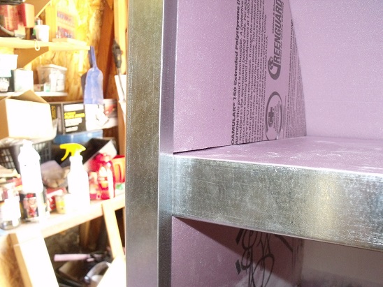

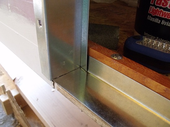

I have been using roof flashing for hard points. Home Depot sells it in a few different sizes. I have used the 2"x3" and 1"x2" for door thresholds, shelf edges/support and bottom edge protection. I am planning on using it for other hard points, such as clearance and porch lights. My plan is to cut darts on one leg of the angle and just push it into the foam until the other angled leg is flush with the body.

It is galvanized so it should not rot too easily....... :thumbsup:
I also used metal (galvanized) drywall beading for some edge armor.
