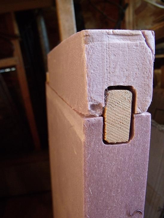

Another thought I had..... What if toy used a router or table saw and cut a grove on edge of foam, then glued a slat of wood in it? then u would have a tongue n groove construction. Would be easier to align pieces when putting together and maybe a stronger joint? been reading that long thread and just about crosseyed now..... :CC and i'm just half way thur?? :beer: :beer:

Postby ghcoe » Wed Oct 16, 2013 5:10 pm
Like this? It does make a strong joint. I made some shelves from some scrap pieces like this and it worked well and strong.

Postby Lonewolf42301 » Wed Oct 16, 2013 5:20 pm
Yes, kinda like that... I was thinking maybe 1/4" groove about 1" deep in each piece then glueing a 2" piece in then butting the 2 pieces together when building. I'm really studying the fiberglass sandwiched 1" foam for strength to substitute for plywood decking under the mattress.... Building the goldbrand trailer, looking for all the weight savings I can find :shock:
