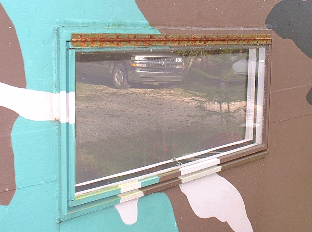

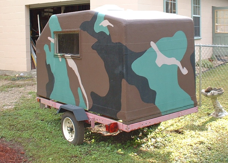

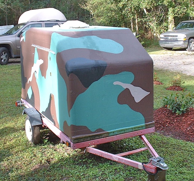

Eagle , my little #1 foamie’ is still sitting out there too ... Pics from today ... the only thing that’s “glaring" is the window hinge ... :frightened: Rusted !!! ... I have a new Aluminum hinge and SS screws all ready for it ... Quart of Red Rustoleum awaits that PINK trailer frame ... :R
Eternabond tape on top around the vent was peeling , or so I thought , but turns out only the top vinyl protectant tape is peeling , the rest has become part of everything else ...easy to mend ...
Just a little cleaning , caulking (Window) and a re-paint (schmaybe’ another color s ) , will make it like new 8) ... Few hours and we’re done.... not bad for 3 years outside eh !!! :thinking:
Ps. the inside remains the same , dry and Empty (no critters have gotten inside ) ... All good there... :thumbsup:
The FS , in the background, is just starting it’s aging “test” living Outside ... I expect no differences .. save the FS trailer won’t surprisingly turn PINK ... Hello Kitty !!!  :R

Where did you find the aluminum hinge???

GPW wrote:I have a new Aluminum hinge and SS screws all ready for it ...
isn't mixing aluminum and stainless a bad idea (galvanic corrosion)?

mgb4tim wrote:isn't mixing aluminum and stainless a bad idea (galvanic corrosion)?
No, unless it is submerged in salt water, then schmaybe.

Postby GPW » Tue Oct 22, 2013 3:19 pm
Got the hinge at the TD parts store online ..
Like KC said , I read where there was the least interaction with Al and SS... Anything has to be better than that cheap hdwe. store hinge and the regular screws I have now ... :oops:

Read on:
Q. I have an application were I have a 1/4" thick plate of aluminum in direct contact with a sheet of 304 Stainless Steel. Also I want to use an all aluminum pop rivet (both body and mandrel made out of aluminum)which will fasten the 1/4" thick plate with stainless steel. This application will see sea coast environment (but not an underwater application). Is there a chance of galvanic corrosion especially the pop rivets weakening out? I am looking for a quick solution. I looked for similar stainless steel pop rivets, but they are not available in the time frame I need to work with.
Saibal S deleted
Operations Manager - Douglasville, Georgia
A. Dead certain for corrosion. You may be able to prevent it by putting an insulator between the two. Try neoprene or something similar. It must not adsorb any moisture however.
Trevor Crichton
R&D practical scientist
The Pheasantries - Chesham, U.K.
A. Epoxy paint the faying surfaces and pull the rivets wet (soaked, including inside) with chromate primer(gives up to corrosion before metal will). Not ideal but good enough for government work.
James H
- Jacksonville, Florida
A. Aluminum in a seacoast environment is not a long term proposition. However, you may want to consider using stainless steel fasteners. The rate of galvanic corrosion is related directly to the ratio of cathode area (stainless) to anode area (aluminum). In other words a relatively small anode area like an aluminum pop rivet will be attacked much faster than a large one like the 1/4" plate. Good luck.
Fred D
high performance architectural metals - Cranberry Twp., Pennsylvania
And there you go...... :SG

hua?? never mind sometimes it is not worth the time trying to understand so...........just what kind of screws do you use with an aluminum hinge ?,,,,,, Brass.......... Oh well I will just paint it again.

Mary , we’re thinking the SS screws will last as long as I do which is all I‘m concerned about ... not going in salt water ,we’re not that close to the ocean ... :thinking:
... and it’s what I have .... ;)

I dab of zinc chromate primer under screw heads will help, it gives up to oxidation before metal will. http://www.jamestowndistributors.com/userportal/show_product.do?pid=64232&engine=msn&keyword=zinc_chromate is one cheap source in a spray bomb ;)

LW, Cool tip !!! Thanks !!! :thumbsup:
