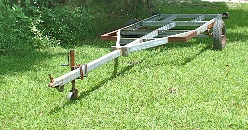

GP,
Is this your trailer?
It looks more like a higway department trailer stripped of its sign, or? than a home made trailer.
The weight rating of the tires will give you a reasonable guess at what the trailer rating is.
Tire rating # x 2.
Rob
