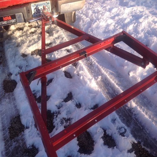

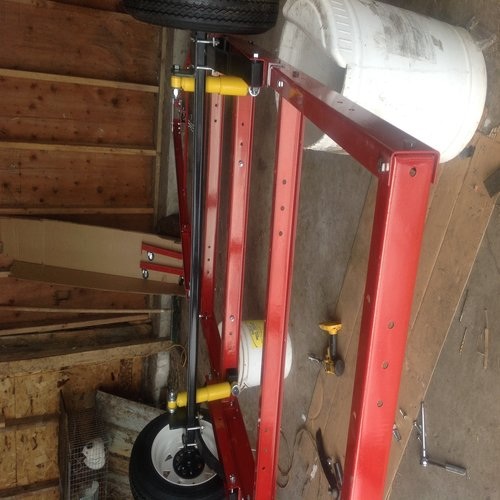

Got my trailer did some work on it today
1st I cut off the brackets that you are supposed to bolt on those caster wheels in the background then I threw away all the crap that allows the trailer to fold then added some Monroe trailer shocks to it after removing the shortest leaf spring
Still trying to figure out how to make my wiring work if I put on an extendable bumper oh well I can do that after the trailer is built if I have to. It is still way to cold to work with any glue yet :( oh yea very important to repack the wheel bearing in the harber freight trailers mine had no grease inside the bearing dab on the outside

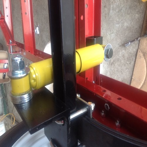

Here is a close up of what I did with the shocks

Now down to business. Did you use shock mounting studs or plain bolts to mount those shocks? The washers make it look suspiciously like you may have used ordinary bolts. If so no beuno. :thumbdown:
Because the rubber busing are in compression, ordinary bolts will never be tight in the mounting holes and they will wallow out in short order. Shock mounting studs on the other hand, are a shoulder bolt, sometimes with a spacer washer that allows the bolt part to get tight to the mounting point while compressing the the shock bushing just enough.
Not trying to rain on your parade, but I would hate to see you have problems down the road. :thumbsup:

Not following you exactly. What you need is for the part that holds the shock to get tight w/o crushing the shock, and the part that anchors to the trailer to get tight and not move despite the shock only being sort of tight.
Take a close look at the pic in this link.
This is a thru bolt style where the stud anchors through a hole with the nut on the back side. The thick washer is compressed between the mounting surface and a step on the stud so that the space for the shock is fixed between the large washer and the flange of the button head. The button head has wrench flats on it so that you can hold the stud while tightening the nut.
Compare that to this style (#75-5100).
The stud is double ended and has an integral hex in the center with a thread and nut on one end for securing to the anchor point, and a smaller diameter thread with shoulder and washer on the other end to prevent over crushing the shock bushing when the retainer nut is securely tightened.
Both of these designs have two things in common; the stud mounts securely to the anchor point with no chance of relative motion, and the shock is maintained securely without crushing it or allowing it to become loose.

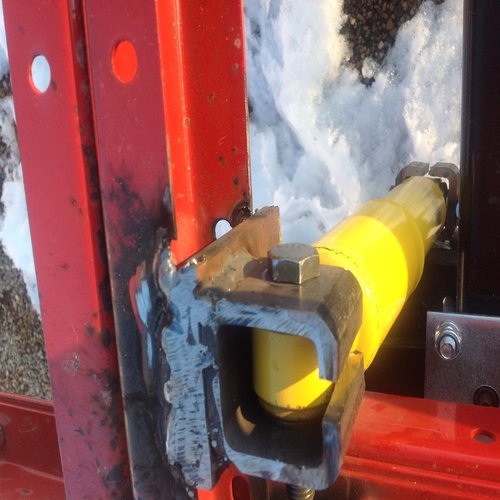

I redid my shocks today. I went to town to find some shoulder bolts but couldn't find any that would work so I bought some bushings that fit inside the grommet then I cut some square tubing that the shock would fit in, cut out the front so I could squeeze it together tight up to the bushing everything tight and secure with the rubber being squeezed just a bit.

I also welded up the corners so that I could take the camper on and off, if I just bolted it to the frame either the walls would cover the bolts or I would have to bolt just on the cross members, I didn't like them options so I welded corners in, that I can get at from the inside

Your new setup should work. For future reference, just go to an auto parts store and ask for "shock absorber bolts".

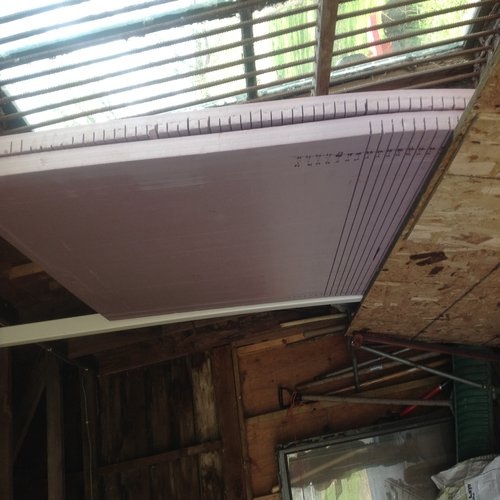

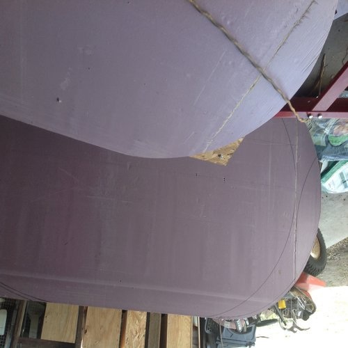

Finally got some decent weather and some time to work on my teardrop. So today I cut out the sides put the floor on and Kerfed the ceiling and glued in some hard points coming
Gizzmo
Posts: 74
Joined: Mon Nov 11, 2013 6:41 pm
Re: The Upllander
Postby Gizzmo » Sun May 18, 2014 11:02 pm
Just Kerfed with a skill saw
