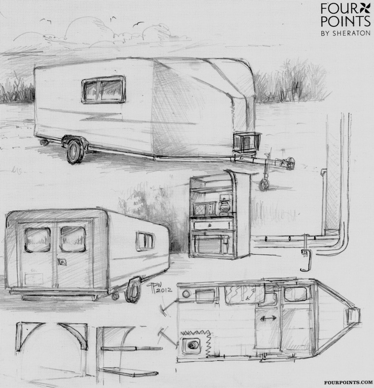

Here's a fast Paint drawing I did of a "Tandem [As in sleeping] TD", as one
possible approach you could take. The Trailer body would be about
5ft to 5ft6in wide and tall [to match the Van], with two 6ft6in long compartments,
the first with room for a queen sized bed, and the second housing a curbside galley
and a 3ft wide bunk set. Three doors should be the minimum used for bed access,
but four would make it much more easy to use.
[Click on the image for a larger view.]
123299
