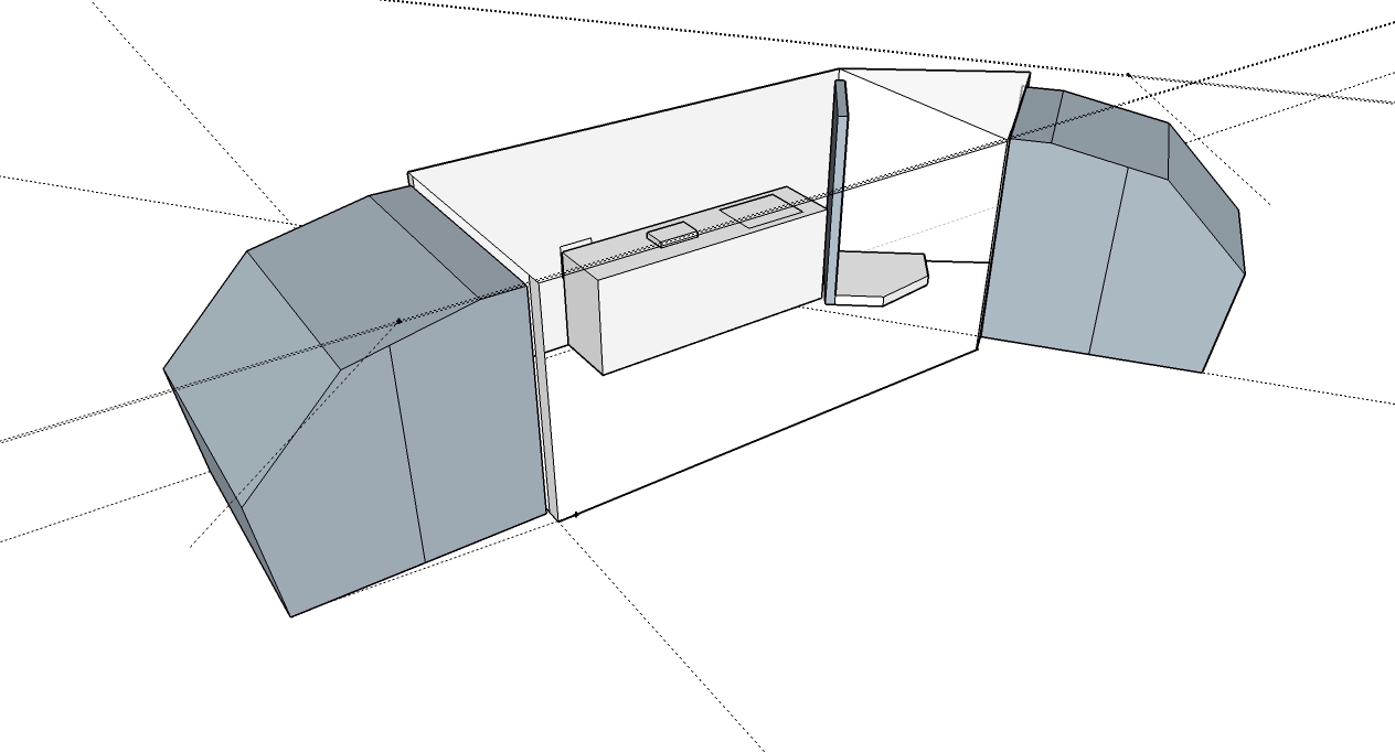

Postby wanabxtrm » Fri Sep 05, 2014 8:28 pm
So I bought some foam to play around with and to insulate/fill my exhaust duct holes for my portable ac vent. (they exit through the 'fueling' port on the side of the trailer).
I've also laid out the sections needed to top the ramps. here's a quick snapshot:
So here's a few questions for you canvasing foam experts:
1- how much do you saturate the canvas when glueing w/ tight bond 2?
2- do you put the glue on the canvas and then adhere it to the foam or paint it on the foam and then place the canvas?
3- do you rough up the face of the foam? I removed the 'plastic' wrap on the face of it. Is it better to leave that (but then you are relying on its adhesion)
