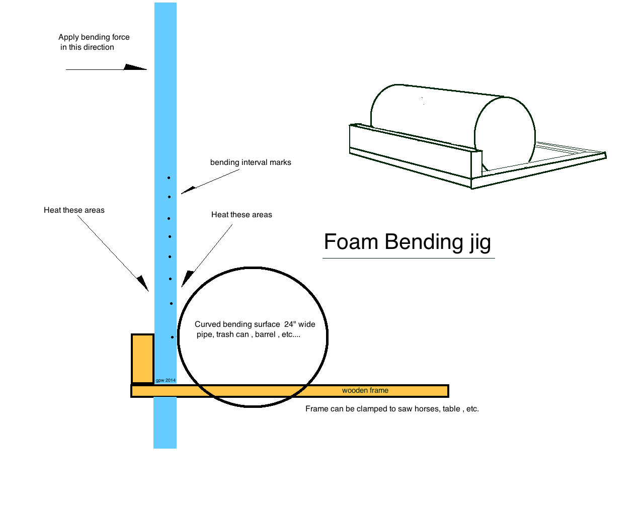

Having curved thinner foams in the past for model planes , I know it can be easily done by the heat method :thinking: ... The idea is to get the area to be curved up to 190F degrees and the foam becomes bendable .. and stays that way forever. (until re-bent in the same manner)
I’ve thought a long time about how to bend 2” thick sheets of foam and how to heat up a large area uniformly ... And then it hit me ... :o :shock: :frightened: I didn’t want to heat and bend large areas !!!... :o :thinking: Thinking of how I’d bend a sheet of foam (4X8) .. it would usually be bent/curved in the long direction to allow for front caps , curved roofs, hatches, etc. But that’s Not really any good eh ... unless we’re only building 4’ wide trailers... :roll:
Now if we cut a foam sheet into 2’ (or less) wide X 8’ long sections, we can have easily bent/ formed pieces , heating only a 24” wide area (easy) making the bending easy , and allowing sections to be stacked together for Wider trailers ... The narrower pieces so much easier to handle , and the foam , being homogeneous material (no grain) easily glues together to form a larger structure , somewhat like Legos . A simple bending form could be built of wood scraps and such , wouldn’t be that big , and could be disassembled after using .. Heating could be done with a simple HF heat gun , or two (front and back at the same time ) which would be pretty quick and efficient .
Pictured below is a simple Proven type of jig that allows foam to be bent in marked increments allowing graceful curves over long distances.. Many ways to build it .. easy to use... and in 24” sections would be downright Quick and Easy ... for Two people ...
Ps. a temporary full form of the curvature could be built to allow for repeating as many identical sections as you want .. :thinking: :D
Foam bending jig.png (46.19 KiB) Viewed 1927 times

Just like when this was first mentioned , (Foamie Trailers) naturally there were some doubters :roll: ... To those I can only say again “Watch and Learn” ... ;)

Cutting the foam to a 2 ft wide piece makes it a more manageable piece. Heat it. Bend it, allow it cool then glue the pieces together. Should work. My worry is trying to heat the panel to the 190. I've tried the heat gun and no luck. Maybe steam bending like woodworkers do. Build a steam chamber add sufficient steam let it become pliable, set it against the form and allow to cool. That should work

OK, addressing one problem ... the heating . As we know there are two forces at play here, tension and compression , the outside of the curve wants to stretch , the inside wants to compress... the center is more or less neutral to those forces . The ideal would be some kind of oven or box to uniformly heat the foam sheets , but all that’s Impractical for only building one or two foamies...
The solution is to only heat a little area at a time , bend a little at a time . :o With a bending jig , one person on the front of the bend, one in the rear , two heat guns heating front and back on a strip only 3”X24” ... Only heating enough to soften the foam, to bend in a small increment .. many small increments make a gentle curve.
Having done this a Lot with thinner foams, In know it’d work on thicker ..

Experimenting will happen when I can gather the right materials to make a jig ... although not that large , it must be strong ... :thinking:
