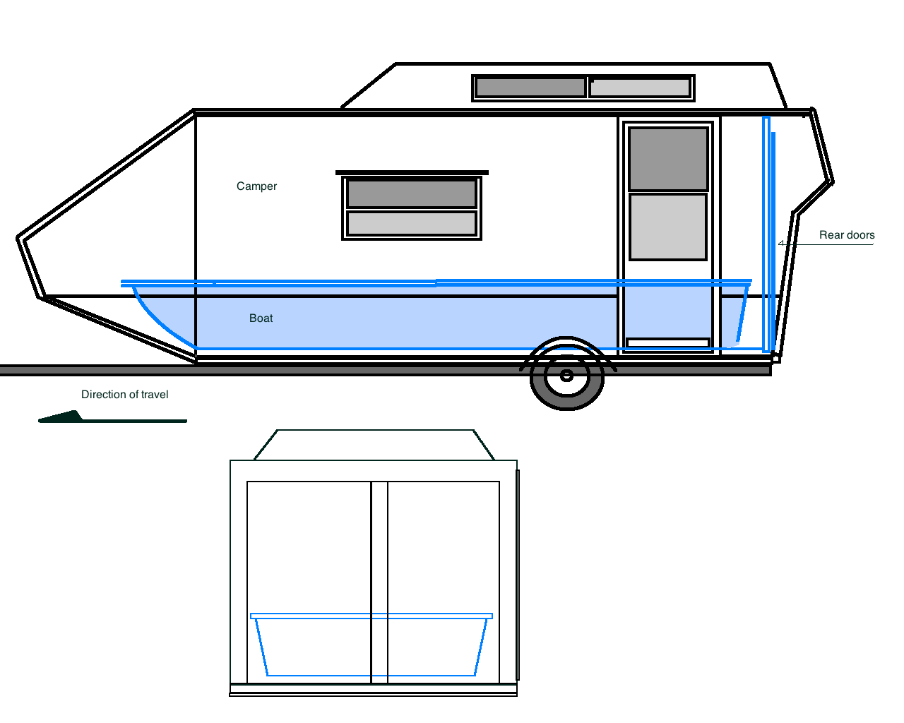

I couldn’t help myself ... Just “had” to make a drawing ... So nice for an all straight cut design , (no curves) ... plenty of room , plus the Boat too ... :thumbsup: 8)
Thinking Main camper ~ 5+ ft. Wide, 4’ High , and then the top addition (the Vista cruiser top) ... Try to keep the whole thing under 80” Tall so it will be easily garageable .. Boat can be 48” Wide,and 8-10' long... overall camper length of ~12-14’ ... ? Something that size would be fairly simple to pull off in Foam ... :thinking: Boat too ... ;)
No kerfing or bending ... cut the panels with the correct angles, glue them together and Bob’s your ... :beer:
It’s that “Angle “ thing again ... :roll:
Re: Interesting TT Design That Could Be Adapted For TDs/Foam
Postby GPW » Sat Jan 10, 2015 9:59 am
And JMHO FWIW , reversing the direction of the trailer makes it more streamline and removes the idea of a heavy clam shell rear end , complete with leaky hinge ... Side door(s) can be placed where needed since the design is basically Square ... ish’ . The new rear , formerly the front, could be built recessed (see drawing) to serve as an overhang in the now back of the trailer , keeping you and the rear barn doors out of the weather, dry , and providing a little streamlining effect too ... :thinking:
All with no bends , no curves... Easy ... flat plates cut with angles and straight lines Only :thumbsup: 8)
