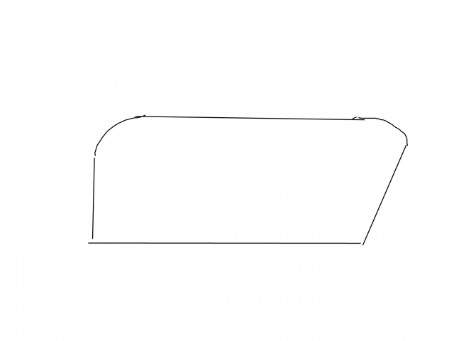

I'm wondering if it would be feasible to "tilt" the front wall of a Benroy to create a place to "recline" when reading or while watching someting on a flatscreen. Could add some kind of padding to the tilted wall. Would give another possible position to be in if stuck inside for awhile during rain etc.
I'm on a tablet and quickly installed a program to draw a rough sketch. Apologies for the roughness. :)

Postby KennethW » Thu Oct 15, 2015 9:57 pm
The great thing about building a tear drop is you can do what ever you think is good for you. A pillow would also work when sitting up. I use a sofa cushion at the head of the bed. I know it is a rough sketch but your radius's are a little small. Go for it. :thumbsup:

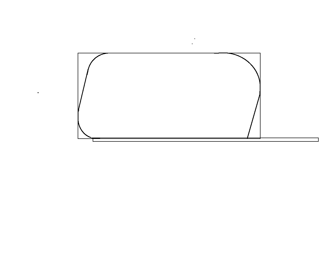

Maybe tilt the back to match .. make it look Cool !!! 8)

You might have a hard time bending that front radius.

The rough sketch really is rough. I just was afraid I wouldn't be able to get the idea across with words only. Not sure what that radius will be in the end, but is there really a "too small" radius when using foam and cloth?
My wife is not tall so that's why I like the Benroy more straight rear. I don't see her being able to lean in for deeper set shelves. I'm not really going to be trying to copy any specific style. Just want functional, light, and strong.

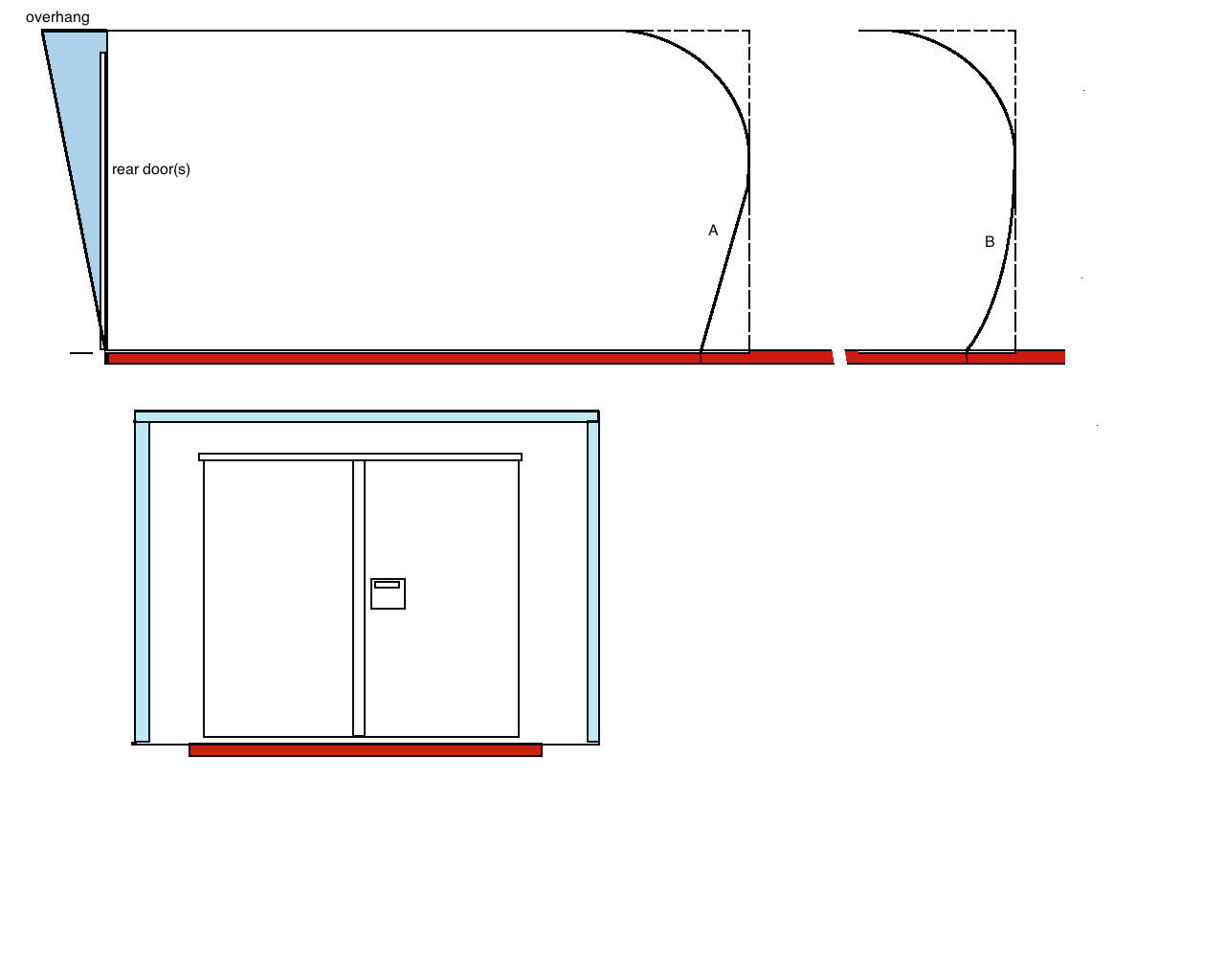

Here’s another thought ... recliner front, flat at the rear with an optional overhang to keep the weather off the door and look cool too ... Plus the option of a Grumman-ish’ front profile ... :thinking: Just an exploratory drawing to search for ideas ... you know !!! ;)

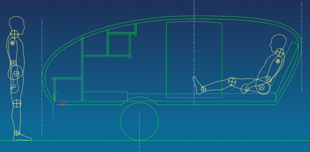

Tom, true. Know this from trying to read reclined in bed. Always end up sliding down. Been already thinking about a special shaped cusion/backrest. Something like this:
136673

Postby Mary C » Sun Oct 18, 2015 10:02 am
Hi and Welcome! I believe the the statement about curves is a little different on big pieces of foam. you really might want to read some of the earlier post about kerfing and some of the problems with taking a 2 inch piece of foam and bending it into place and all the problems (dust) and how easy it is to goof up. I went with thin foam to make my curves and it was very difficult. My next foamie is a standie, just a little curve on the front. Good luck and I will be very interested in how you build yours. For what it is worth I take a few extra pillows and get the reclining position.
