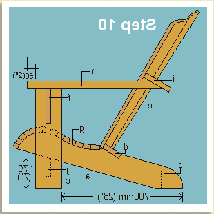

Has anyone seen a teardrop with a strange front end like I have shown here?
I've fashioned the front area to have the same approximate angle as an adirondack chair, but to fit a person's head in there I had to move the curve way up...
There's nothing quite like that in the Hall of Fame.

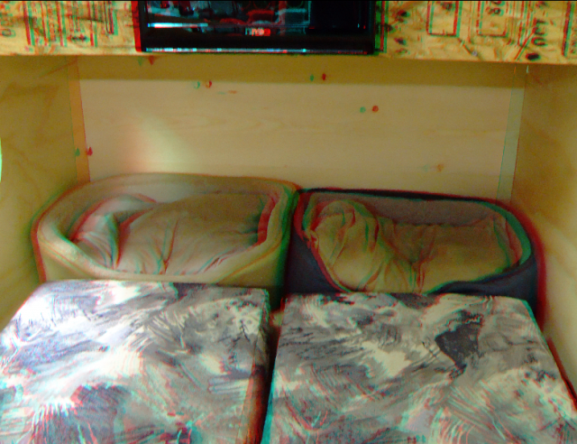

You're right. The cabin is extra long. I had to add an extra 2 feet to get the dog beds in there by our feet.
This mockup is only 4' wide, the real McCoy will be 5' or 5 1/2' wide.
P.S. How many people here have those red and blue 3d glasses?

Clever Mike. Should be pretty aero with the front top being closer to your TV and the long, gently sloping back.
As for the Adirondack chair seat shape, you could probably simulate it (without a drop floor) with a custom made pillow.
Have you thought about small side pullouts for the dogs so you don't have to make the trailer longer?

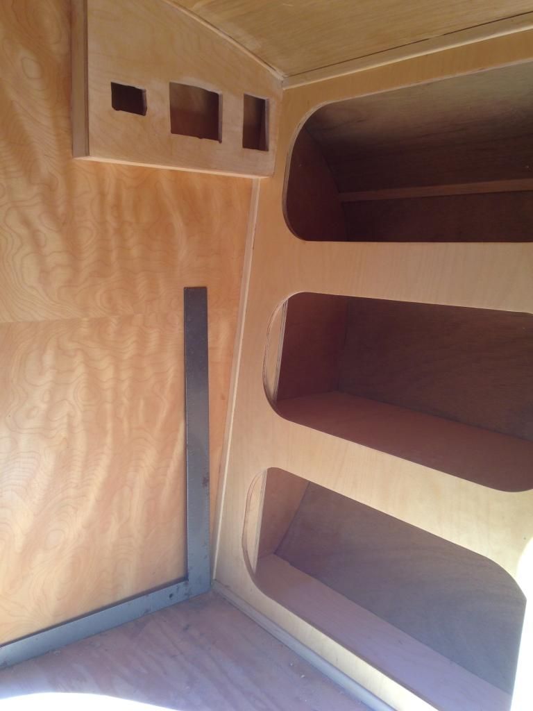

I read somewhere that the ideal angle for the back of a bench is 97 degrees so I tilted my headboard back accordingly. Lost a little storage space but kept the outer profile that I wanted. The bottom two rows of openings on the headboard will have inset doors with flat hinges and magnetic catches. Top row will remain open to act as a shelf. [Image
