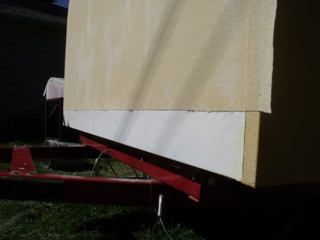

Postby GPW » Sun Oct 25, 2015 6:07 am
As we found , the real trick using un-shrunk canvas was to leave enough extra material on the ends so you can trim it when it’s dry ... If you fit/cut it first , it may shrink beyond where it’s supposed to ...

Postby ghcoe » Sun Oct 25, 2015 8:46 am
GPW wrote:As we found , the real trick using un-shrunk canvas was to leave enough extra material on the ends so you can trim it when it’s dry ... If you fit/cut it first , it may shrink beyond where it’s supposed to ...
Yeah......what he said. :thumbdown:
Too short.....
