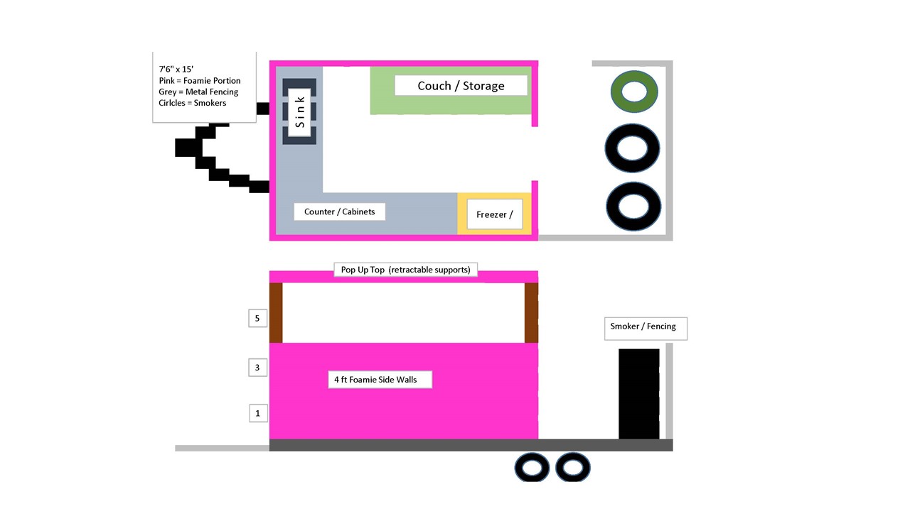

Postby Smoking Pill Doc » Thu Mar 03, 2016 2:46 pm
Hoping a picture might help. The couch will pullout on each end for a bed (we start cooking at midnight). I know the size is much bigger than traditional on this site, but the foamie part is accurate at least. I will use 2" foam for the base walls. The pop up roof will have 4" side walls (so there can be an overlap with base wall) with a 2" roof top.

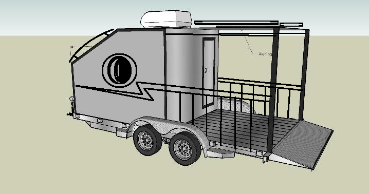

Postby GPW » Thu Mar 03, 2016 3:39 pm
Here’s a drawing from a while ago ... just for ideas ...

Postby Smoking Pill Doc » Thu Mar 03, 2016 4:10 pm
Yes! That is it (your drawing is much nicer though).
So it should work then....cannibalizing a travel trailer should be OK...now the biggest question is the wife OK with it?????

Postby GPW » Fri Mar 04, 2016 6:05 am
Note... the sketch above was not one of mine .... I think it was Steve from Texas .... we just did some decorating on his drawing ... ;) (what you see here )

Postby Smoking Pill Doc » Fri Mar 04, 2016 7:31 am
The trailer set up posted by GPW/Steve would be ideal, but I don't have a drop axel and they are expensive around here.
So I bought the donor TT last night. There are a lot of salvage items from the TT which was the basis for buying. The bad is that the floor is shot and street side wall is shot, so I have a lot of dismantling to do. This is OK as I need to chop 6ft off the trailer (BBQ competition sites are typically 20'x20' [need to pay $50+ more to get a bigger spot]) and probably most importantly I need to drop weight (personally and trailer wise :lol: ). Per manufacturer, dry weight is 3,335lb and my TV max tow weight is 3,500lb.
Design....I love the concept posted by GPW. It would be easier in setup as all you do is pull up, level the trailer with jack stands, and cook. The bad it feels like a daunting task to ensure travel stability of a standie and increased wind drag while towing. Additionally part of the competition fun is the camaraderie that you develop with the other contestants. By going with a pop up style left open in good weather, it may open up conversation...then again a foamie will probably generate a lot of conversation :R .
