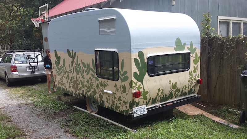

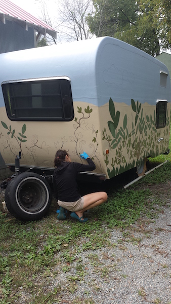

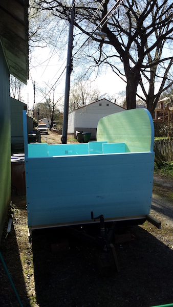

Here is the present state of my camper, still painting it.
Painting the front.jpg (158.03 KiB) Viewed 5720 times
Painting foamie.jpg (241.33 KiB) Viewed 5720 times

Postby dales133 » Sat Oct 22, 2016 1:45 pm
Looking good. Cool paint job

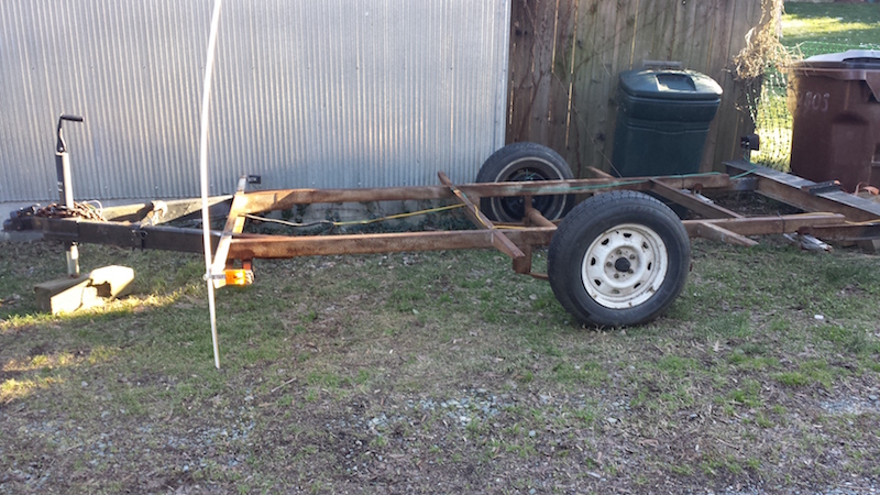

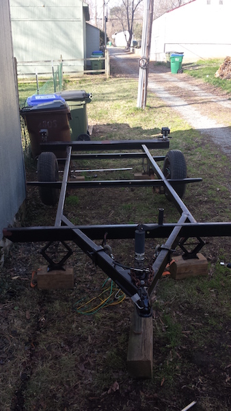

Here is what I bought back in January this year;
Camper chassis.jpg (273.07 KiB) Viewed 5715 times

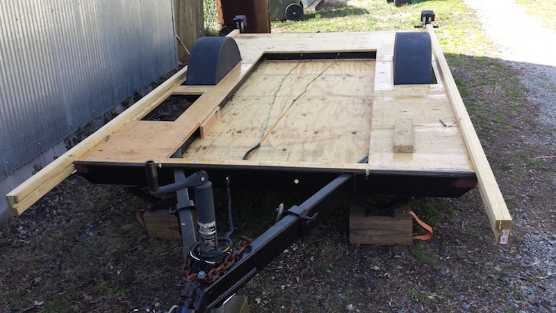

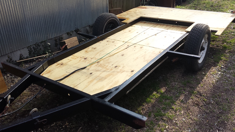

More pics, chassis is painted and the drop floor started. I cut out one cross member of the frame and figure that 3/4" treated plywood glued and screwed to the under side of the frame would give it back some of the loss in strength.
Starting the drop floor.jpg (239.06 KiB) Viewed 5667 times
Floor started.jpg (240.24 KiB) Viewed 5667 times

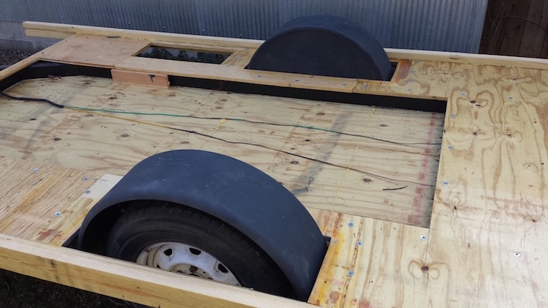

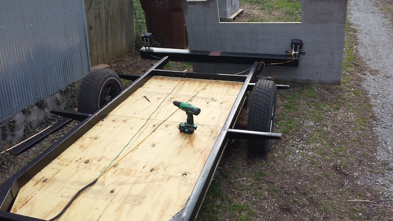

This is how the floor was attached and pieced together. After the walls were up I checked to see if I could get the tires off, NO, so I ended up cutting away most of the wood rail that goes along the outside part of the wheel wells. :?
Camper floor progressing.jpg (243.44 KiB) Viewed 5652 times
camper floor progress.jpg (208.14 KiB) Viewed 5652 times
camper floor.jpg (183.34 KiB) Viewed 5652 times

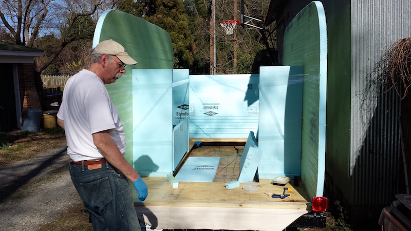

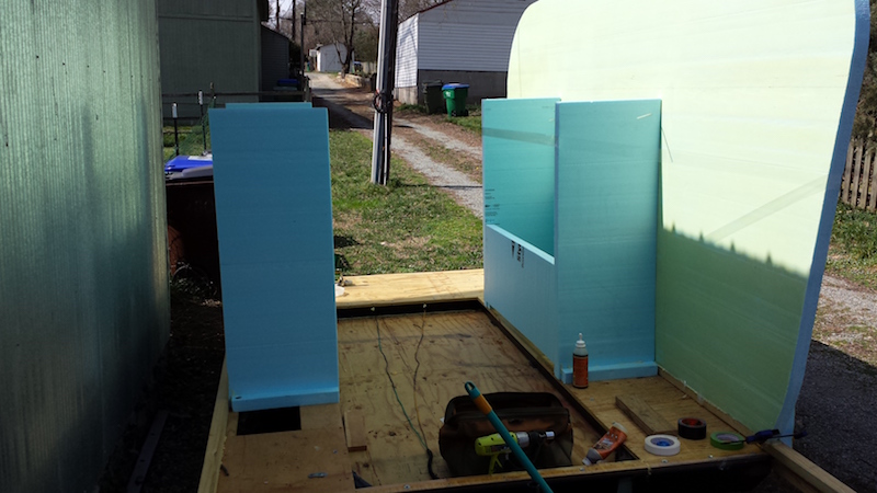

Back in March and April we had some really good weather so I avoided work and assembled the walls and got things going.
Wall panels glued together.jpg (154.06 KiB) Viewed 5623 times
Walls going up.jpg (168.27 KiB) Viewed 5623 times
Walls going up with friend's help.jpg (222.19 KiB) Viewed 5623 times

Postby Don L. » Sat Oct 22, 2016 8:31 pm
When the first sides went up it was windy so I used the foam cut offs as braces for the sides. I fastened the back wall to the sides with 4" screw with washers on them, which pulled it tight until the G-glue dried, then I took out the screws for re-use.
Walls, and ends.jpg (145.32 KiB) Viewed 5622 times
