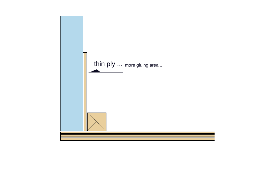

You could get some 3” drywall screws , and run them partially into the foam/wood to hold the panel in place while the glue dries ... then remove them later ... Gorilla Glue doesn’t expand very much ( depending on the local humidity) when you Don’t add water ... Maybe some other ( non expanding) glue might be better for your purposes ... As we found out long ago , the glue is not as critical an element as all the strength of the body comes from the outer skin ( sock ) holding everything together ... You could go even further by adding thin plywood ( or even chipboard ) extending up the wall for more gluing area ( see drawing) .... All how far you want to take it .

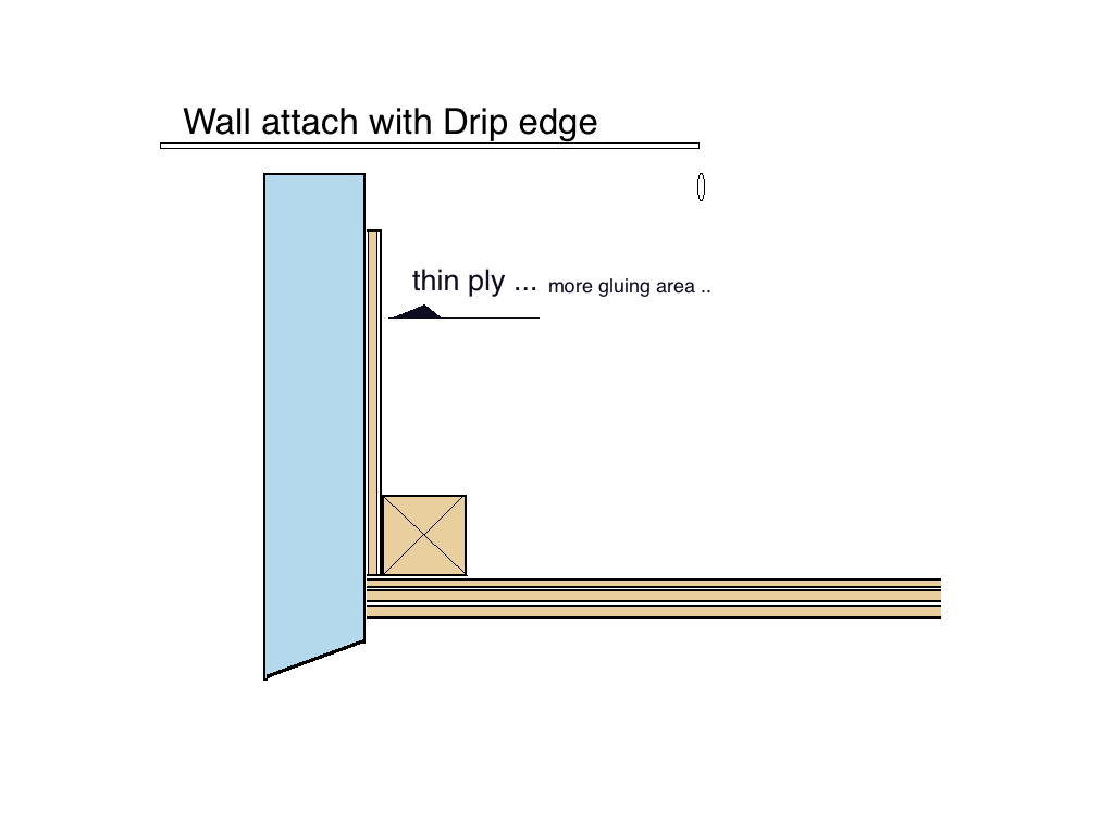

Postby GPW » Wed Apr 12, 2017 9:54 am
And if you live in a rainy area ( or an area that wasn’t rainy, but is now ) then do please consider adding a drip edge of some sort ...
just one suggestion .. ( yes, another drawing) :o

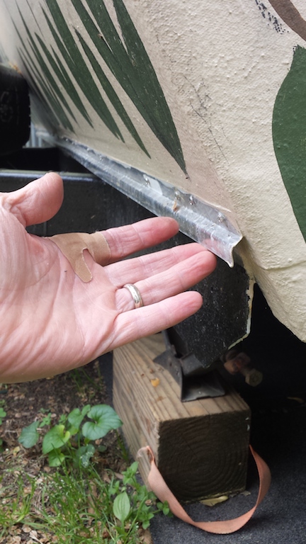

Postby Don L. » Wed Apr 12, 2017 10:58 am
There's this stuff in the tile dept. for a drip edge, at Lowe's or HD,forget, but it is aluminum and a buck or 2 for 4' of it. I attach it with screws and adhesive caulk. I'll try to get a picture of it, and it's pretty low profile.

Postby Don L. » Thu Apr 13, 2017 10:59 am
I'm not sure what it is called, but it was in the racks in the tile/flooring dept. It does not come pre-drilled for screws but a screw will go through it pretty easy.
Found a link; https://www.lowes.com/pd/M-D-Z-Bar-Alum ... AtL58P8HAQ

Postby Don L. » Thu Apr 13, 2017 11:10 am
Here it is on Bluebird-
