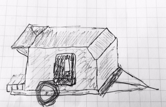

Decided to take the plunge for myself. My vision for a "foamie for one", just me and my small dog...was this:

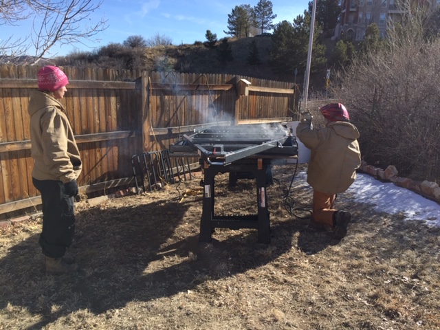

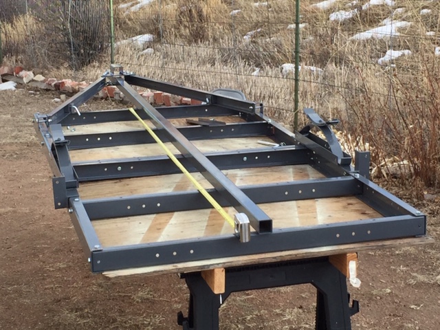

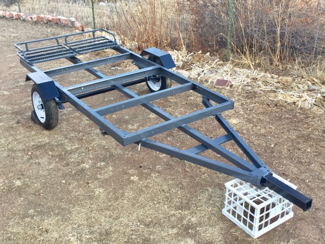

I was going to bolt on the 2x2 inch steel tube, but decided to hire a "mobile welder" off Craigslist, so that I could also move the axle back a few inches in case I wanted to go with the larger 13 inch rims in the future:
The "mobile welder" went buck wild and every time he saw a bolt, he welded! We moved the axle rearward 3 inches, sawed off the holders for the fold up wheels, and installed the 2x2 inch steel tube "spine" (really transforms this trailer to be MUCH nicer). He also installed (welded on) a rear cargo carrier with extruded metal below. There are 2 inch receivers on both ends of the trailer. I will fabricate a removable hitch for the front:

I thought looked a lot like my initial concept drawing....

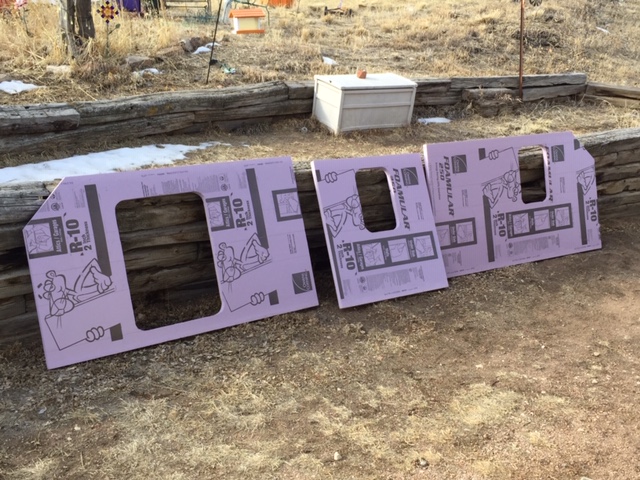

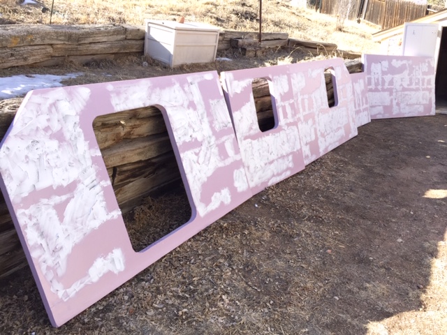

So far so good. My windows and doors came in, so did the cuts for them:
And then spackled:

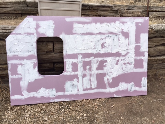

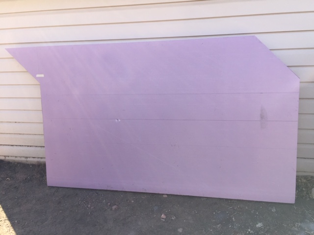

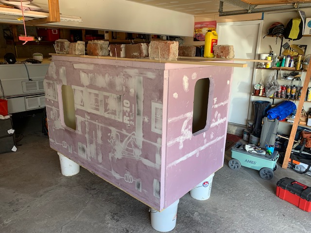

I messed up on the drivers side window cut out, so had to buy another panel. Wasn't too upset by this as I didn't like the window location on my first attempt. So bought another panel and made my cuts, and spackled for the deep printing on the printed side:
Here is the corrected panel:
When the spackle was drying I thought "oh no"...yep, did it backwards and the printed side will be on the outside! Was supposed to be "all printed sides on the inside"!
Oh well, will just spend more time on the spackle/smoothing for this panel before the canvas goes on.

Postby Pmullen503 » Mon Jan 27, 2020 9:41 pm
A hot iron over a wet cloth will steam out that writing. So much so that you may not need to use filler.
Pmullen503
Posts: 1182
Images: 67
Location: Fond du Lac, WI
Re: A Foamie for one
Postby JazzVinyl » Mon Jan 27, 2020 9:47 pm
Pmullen503 wrote:A hot iron over a wet cloth will steam out that writing. So much so that you may not need to use filler.
Really? It will pull up the sunken lettering? Will give that a go! Thanks!
JazzVinyl
Posts: 167
Images: 211
Joined: Wed Mar 27, 2019 2:30 am
Postby Pmullen503 » Tue Jan 28, 2020 8:17 am
Just make sure there is always steam so you don't melt the foam. Don't let the cloth go completely dry.

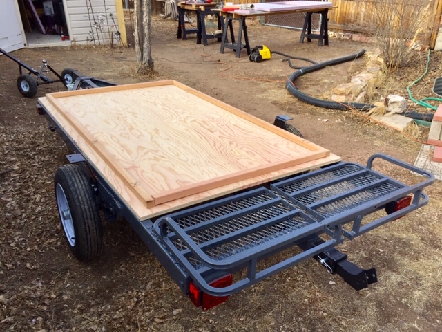

Worked on the floor some, today:

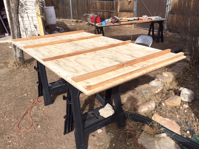

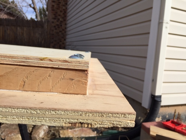

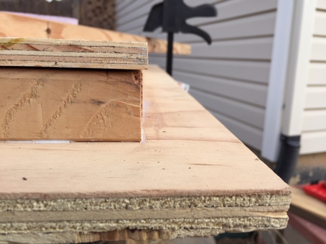

Postby JazzVinyl » Fri Jan 31, 2020 8:10 pm

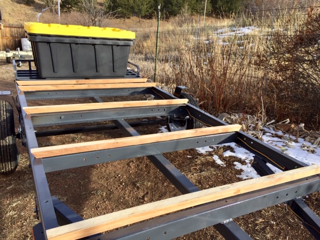

Ripped down pressure treated 2x4's to be the 1x2 floor spacers:
JazzVinyl
Posts: 167
Images: 211

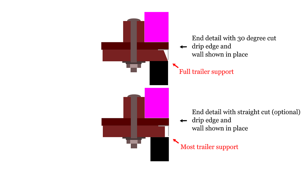

Postby ghcoe » Fri Jan 31, 2020 11:05 pm
JazzVinyl wrote:Ripped down pressure treated 2x4's to be the 1x2 floor spacers:
Floor spacers are upside down. The tapper is designed so that it clears the drip edge, but has full support of the trailer frame.
spacer
Floor Spacers End Cut Option s.png (43.2 KiB) Viewed 4850 times
George.

Postby JazzVinyl » Sat Feb 01, 2020 6:53 pm
ghcoe wrote:Floor spacers are upside down. The tapper is designed so that it clears the drip edge, but has full support of the trailer frame.
10-4 on the spacer orientation, George. These are for the side walls, do you also 'drip edge' the front and back, bottom edges?

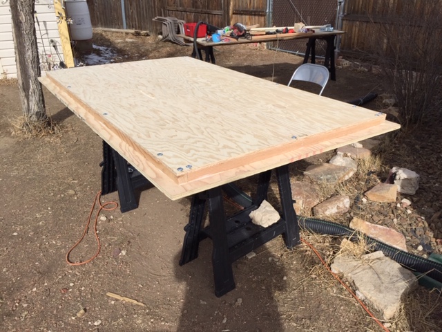

Postby JazzVinyl » Sat Feb 01, 2020 7:08 pm

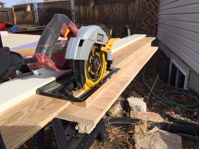

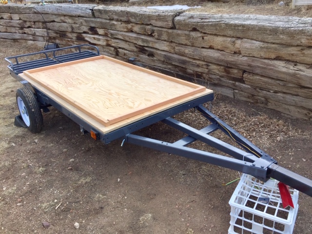

Some progress today:
I added an upper floor over the inner rails. I wanted that three inches of floor space that the inner rails occupy back (also want insulation in the gap between and some electrical wiring will be in there, too:
The upper floor was a smidge longer than the inner rail edges:
Circular saw to the rescue:
Now were good:
Five spacers between the trailer and floor. In my build,. four may be enough.
George, do you think leaving the last one off would be okay?

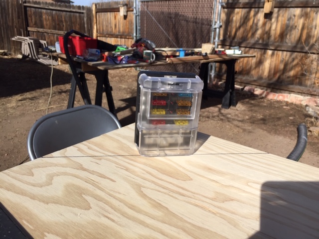

Starting on electrical...this is a 6 circuit fuse / terminal box:
Planning on 3x 12v outlets inside, one 12v outlet outside, one switch for lights inside and one switch for a porch light, 6 circuits, total.
Also, George...my spacers are thicker then the 1x2's you specified. Might have to go with a different drip edge (like on your house) to account for thicker spacers. Think that would work? Or should I fall back to the specified 1x2 spacers?

Postby ghcoe » Sat Feb 01, 2020 7:20 pm
JazzVinyl wrote:George, do you think leaving the last one off would be okay?
Cheers...
If there is not too much overhang it should be ok. Especially since you are making a box frame for the floor. Which if you put a sheet of foam in you would insulate the floor more. Just a suggestion.
Spacers probably would be fine. My spacers show some as well. I don't really notice since I painted the spacers the same color as the trailer. No biggie.

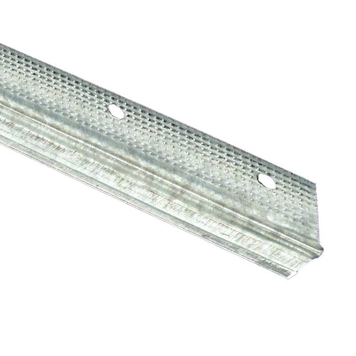

Postby JazzVinyl » Sat Feb 01, 2020 7:53 pm
ghcoe wrote:If there is not too much overhang it should be ok. Especially since you are making a box frame for the floor. Which if you put a sheet of foam in you would insulate the floor more. Just a suggestion.
Yes I definitely plan to insulate the floor.
And I wonder if you could post some closer photos of the drywall item you are using as the drip edge?
Do you "drip edge" front and back, too?
Appreciate!

Postby ghcoe » Sat Feb 01, 2020 8:09 pm
Appreciate!
Corner Bead
Corner bead.jpg (43.23 KiB) Viewed 4791 times
Yes, all four sides.

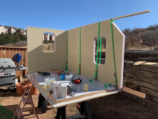

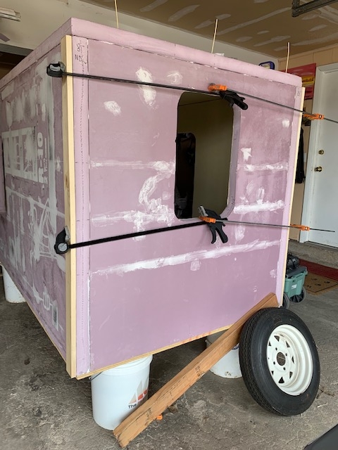

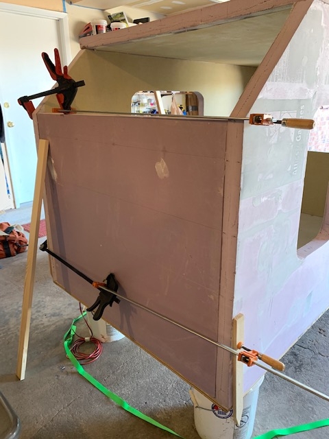

Postby JazzVinyl » Sat Mar 14, 2020 9:44 pm

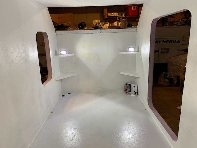

Making some progress here. Started the glue up:
Then moved indoors due to evening forecast calling for steady 35 mph winds, to glue up the passenger side:
The roof was glued on next (the rear panel is just taped on to stay, at this point):
Next day, glued up the front 3/4 panel:
Then the rear panel was glued in place:

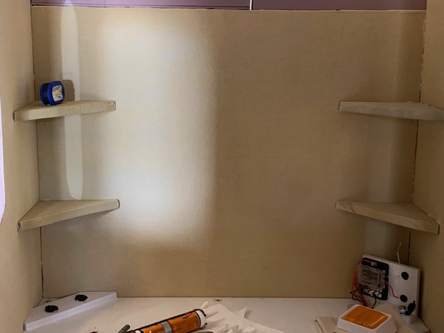

Installed front corner shelves (these have screen glued on the bottoms' to make them very stiff), you can also see my 12v outlets:
Next day, caulked and painted (primer) the innards (you can see my corner shelves again and the 6 circuit fuse box)
Soon, it will be time for the challenge of the outside canvass work...
Getting lots of help/advice from George Coe II, which is very much appreciated!!
