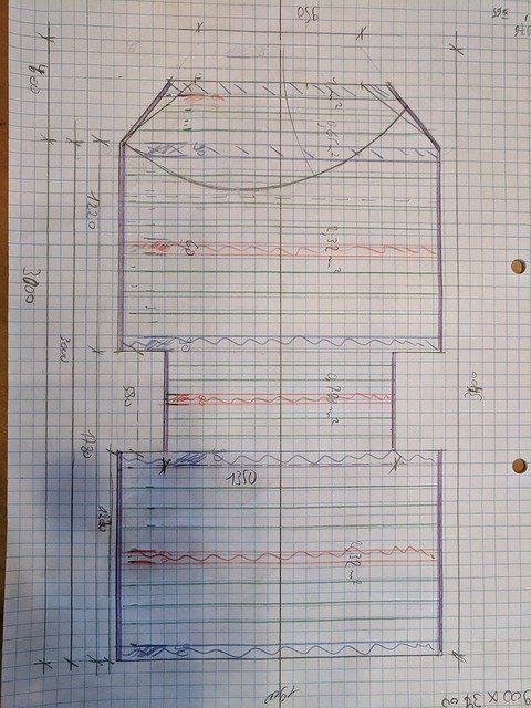

I have finished my floor, now need to attach it to the trailer. (Floorplan, metric)

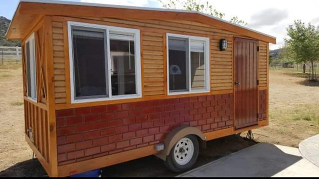

Thanks for sharing this. I have seen the tiny home in the upper photo. Have you seen the way he did the post framing to minimize lumber? I would also like to do something similar but on a larger scale so I will be watching your progress.
I assume you have ruled out poor man's fiberglass for the outside? If so, I am curious about what made you decide that way if you were willing?

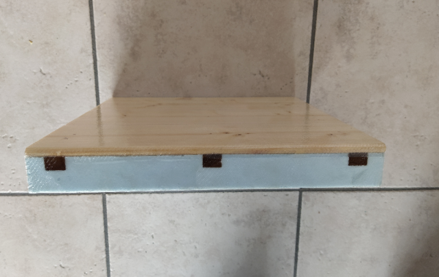

I bought some cheap 3mm rubber flooring material to glue on the trailer before attaching my sandwich floor, mainly to prevent rubbing between metal and plywood. As an added benefit, vibrations will be dampened slightly i hope.

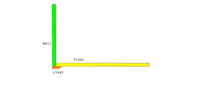

Working on the walls right now and have a question for the wall to floor joint.
I am using 30mm foam, routed 10mm slots every 15cm for attaching thin wood strips. After this the whole gets fiberglassed inside and out. On the inside i am thinking of using cork glued to the fiberglass.
A question : Is there a reason why i haven't seen the use of a cleat that is epoxy glued and screwed to the underside of the floor, extending to support the wall and this joint, wall, cleat and floor (1 1/2 sandwich) ? There will be glass tape from the bottom 2 or 3 inches going around the cleat and to the underside of the floor.

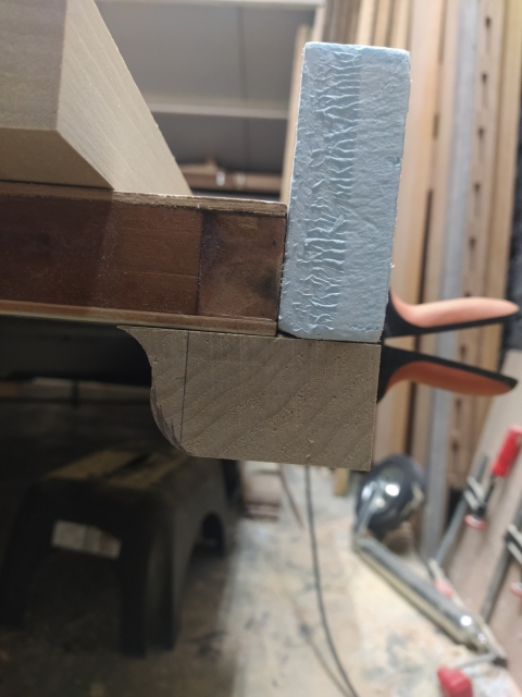

Postby woodie72 » Sat Apr 03, 2021 12:51 pm
Lacking feedback i went ahead and shaped the cleats.
They will be epoxied and screwed to the floor. The side wooden slats will go to the bottom, overlapping the cleats, rounded over and then fiberglass will wrap around the sides, the cleats and will extend to the bottom of the floor. Shaped so the glass nicely follow the curves. Cleats extend 2 inches under the floor. Foam will be poly glued to the side of the floor and to the cleats. I will add a wooden batten on the bottom of the foam, so glued up will be easier, no need for clamping straps.

Postby pchast » Sat Apr 03, 2021 8:49 pm
I believe there is no need to add a batten to the foam. Depending on the
type of glue used, there may still be need to use clamping regardless of
batten or none. Standard wood glue will stick to prepped foam with a
longer curing time.
:thinking:
Actual best approach is more dependent on how you are attaching your
outside skin?

Postby woodie72 » Sun Apr 04, 2021 3:36 am
pchast wrote:I believe there is no need to add a batten to the foam. Depending on the
longer curing time.
:thinking:
outside skin?
I will be using an equivalent to gorilla polyurethane construction adhesive. My thinking was if i can use a couple of screws to pull the panels to the cleat, it might be easier to clamp the big 11 by 6 feet approximately panels with straps.
Come to think of it, would a long batten screwed from the outside to the floor suffice for holding the panels to the frame and stop them moving up while the glue cures :thinking:
The outside skin will consist of wooden slats, like cove/bead kayak construction, and then covered with fiberglass, mimicking the sock like the foam/canvas method.

Postby QueticoBill » Sun Apr 04, 2021 5:19 am
A sip or stressed skin panel relies on a continuous skin - like plywood - for tensile and compressive strength, and resistance to racking. Slats or clap boards will not be close to a monolithic skin.

Postby woodie72 » Sun Apr 04, 2021 1:17 pm
Doesn't bead and cove strips/strip planking under fiberglass create a continues skin ?

Postby QueticoBill » Sun Apr 04, 2021 1:39 pm
The tongue and groove has no shear strength so just the fibreglass. Perhaps 3 or 4 or more layers of glass and resin would come close to a piece of ply. Stability perpendicular to grain will be iffy because of changes from humidity, especially outside. No tensile strength in t&g. Just pulls apart.
Look at sips. Continous one piece skin. The skin is subject to tension and compression parallel to the panel.
Just like a hollow door with honeycomb, or an I beam or a tji (wood joist) all the stress is in the flanges or skin.
