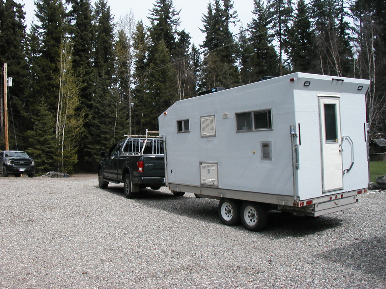

Just recently took our build out on it's trial run, posted a pile of pictures in my Gallery, unfortunately they aren't exactly in order. I am seeing if this picture attachment works for me. We started with the old camper on the trailer, and ended up with a 7x14 foamie camper with PMF.

Here she is on her maiden voyage....a successful fishing trip. We had below zero, hail, rain, snow, sun, wind and good fishing enjoying the fruits of our labour. My thanks to all the previous posters that let me study how you did things, I can say it worked out very very good and I wouldn't hesitate to encourage others to build their own foamie with pmf.
