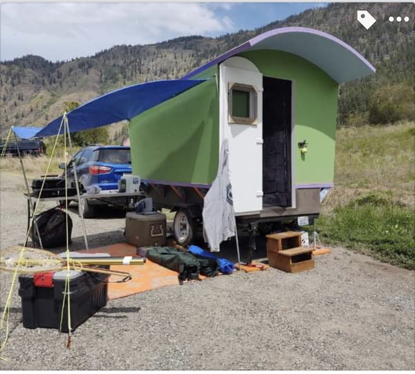

How much weight is saved with a Foamie camper build vs a plywood/wood small camper build? I hope to build a 6”x10’ vargo type “standy” camper similar to the image below. My tow vehicle weight limit is 1500lbs.
If you build something similar to the camper in the photo using traditional methods, it will more than likely weigh well over your 1500 pound max.
And by the way, because of the frontal mass of that design, it'll have a lot of drag. In other words, for a small car, it'll be a beast to tow at anything above 50.
I don't mean to be the bearer of bad news.

tony.latham wrote:.........And by the way, because of the frontal mass of that design, it'll have a lot of drag. In other words, for a small car, it'll be a beast to tow at anything above 50.
:thinking:
That's going to be like towing a parachute....
A vardo has the advantage of standing room, taller doors, etc. which makes it easier to reconfigure the inside for sleeping, eating, sitting and cooking. So, if you don't plan to move it very far or very often, the design has definite advantages.

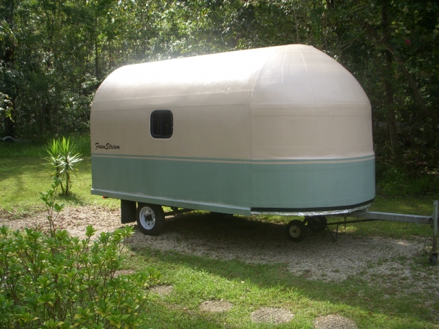

I’m going to make the front end similar to the FoamStream here on the forum, for better aerodynamics. Think that will help?

The FoamStream does tow very easily … like nothing is there … My old square Jayco towed like a Barge in molasses … ugh !!! Shape is everything … :thinking:

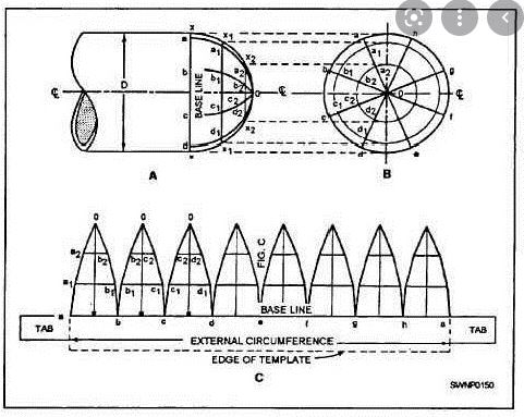

BrianInVA wrote:I just found a tutorial on making cone shapes with foam so the process to cut and glue the top semicircle at the top of the front end to meet the roof line looks fairly straightforward.
You May find a search for (Orange peel pipe cap) Handy for a shape like that.
