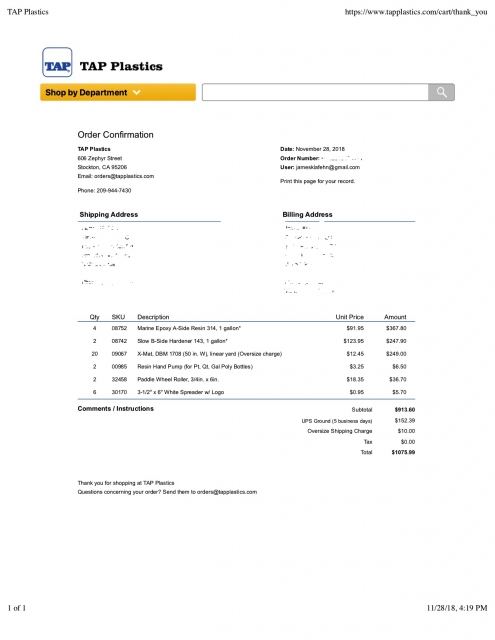

I just ordered my fiberglass and resin for my T-Rex aero build.
Check out my youtube channel if you want to see my build. youtube.com/jimbo69ny
