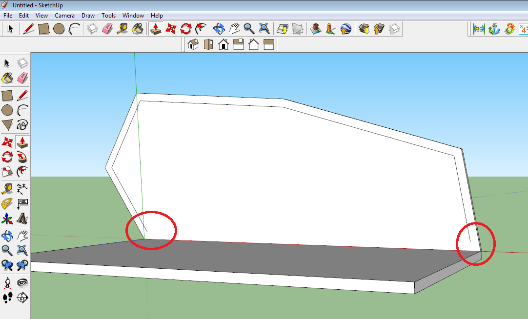

So how do I extend a line, without losing my parallelism to the outside profile...? (Hoping it's not an eyeball kind of a thing!)

I did find this... but it creates a new line, rather then extending an existing line...

As you figured out you can not really extend a line like in normal CAD programs. It makes a new line and is treated as such. What I would do is use the tape measure icon to create a guide line. Select the tape measure, click and hold on the line that you want to extend. Move the mouse off the line then back over the line. This will create a guide line on top of the line you want to extend. I would then use the select tool to click on the line and delete it. You then draw a new line using the guide line to ensure to stay in the same plane as the outside profile.

I"ve used the "pink line" method since I started with SU, and it works every time. After awhile, it becomes sort of natural to keep things in a plane. Just hang in there.

Just extend the line through the plane and then select the "overage" and delete it. it even works when extending the line when it turns green (green meaning that it is continuing in a straight line from the point of origin

I played with guidelines for a couple secs this morning before I left for work. It works... I can delete the old line, and draw a new line. But it doesn't snap to the guide line, only the end point of the guideline.
Is there a way to make it snap to a guideline? How about to the intersection of two guidelines?

The only way I have ever found to get the new line to coincide EXACTLY with the old, is to go the "pink line" route. Take the existing "too short" line and click on the beginning and the end. Then go back to the beginning, click on that, and extend the cursor out past the end of the line, and the "pink line" will display itself. Drag it out beyond where you need it, and click to make it permanent. Then remove whatever length you don't need.

I usually set up guide lines and guide points to draw lines with. You can create your first guide line, then click on that guide line and drag the mouse in the direction that you want a new guide line. Type in the number of inches that you want to space the guide lines. You then create a guide line that intersects with the guide lines you already have. Then draw a line between the guide line intersections.

To extend an existing line, select the line tool and start on the end of the line you want to extend. Go back on the line you want to extend and press and hold the shift key on the keyboard, keeping the shift key down will lock the line to be coincident. Extend the line as far as you need. Best to go further since it's easy to erase any excess.
If what you wanted is to draw a line parallel to an existing line which is part of a close area, use the offset tool in the "Tools" menu. When the offset tool cursor "touches" the enclosed area, it will be highlighted. Click on the area and move the cursor inside or outside of the area and a parallel line will be drawn. You can enter a numeric value if you want an accurate offset. The offset line drawn will also follow curves with a radius +/- the offset.
Sometimes when drawing an offset line inside, the offset line will form "horns" if the offset exceeds the radius of a rounded corner. In that case, simply erase the unwanted horns.
