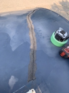

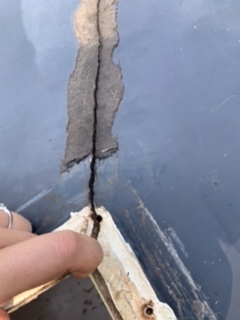

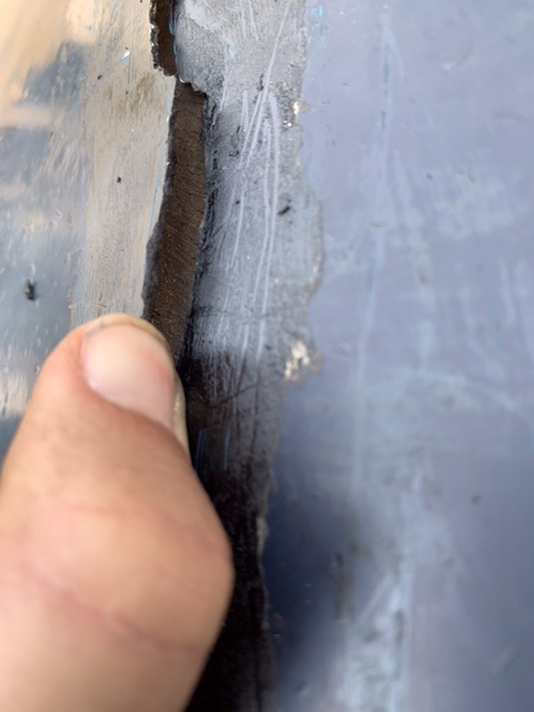

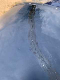

I do have a new problem though. When I was on the roof I saw that a repair made my the previous owners failed and there’s a big crack in the filon on the roof. It had been caulked with something but whatever the sealant was cracked along that fault line. It started at where the old vent corner was.
I scraped off all the old sealant and now need to re-patch this. I did look under the crack as much as possible and it doesn’t look like there’s any water damage under the filon. It’s extremely thin and below it is an inch of styrofoam so there’s really nothing to rot. We also, thankfully, live in a desert so it’s been hot and dry all summer with very little rain so any moisture would have been well dried out.
Can I just use the ProFlex RV stuff to seal the edges of the crack back together? A different forum was talking about chiseling away the rough edges and fiberglassing in the crack but that seems fairly challenging and we’d never get it to match. Sealing it with clear sealant won’t be completely un-noticeable, but it would at least blend enough since it’s on the roof. A huge stripe of fiberglass would be much more obvious.
Any advice you could share would be so helpful! Thanks for all the help so far!
Sealant won't fix the break. I would figure out a way to pull it together and then fix it using a 4-6" piece of fiberglass cloth (6 oz perhaps) and epoxy. It's not a big learning curve.
You'll have to remove all of the sealant, of course.

Thanks Socal Tom. That’s the forum I had seen before and was hoping to hear that fibreglass wasn’t necessary, but it sounds like it is.
I appreciate the advice Tony. I did look up the process and it doesn’t seem that intimidating when it’s broken down. They have a Bondo kit at Canadian Tire. Online I read that Bondo isn’t the greatest quality in the world but should work just fine for this application. Do you have any advice or recommendations for what product to use?
I'm not familiar with that stuff. I recommend you use epoxy resin, not polyester like I assume the Bondo stuff is. Epoxy has a much higher adhesion. You'll have to remove the gunk the previous owner used and sand the filon down through the color.
And of course, you'll need to paint the patch. :frightened:
